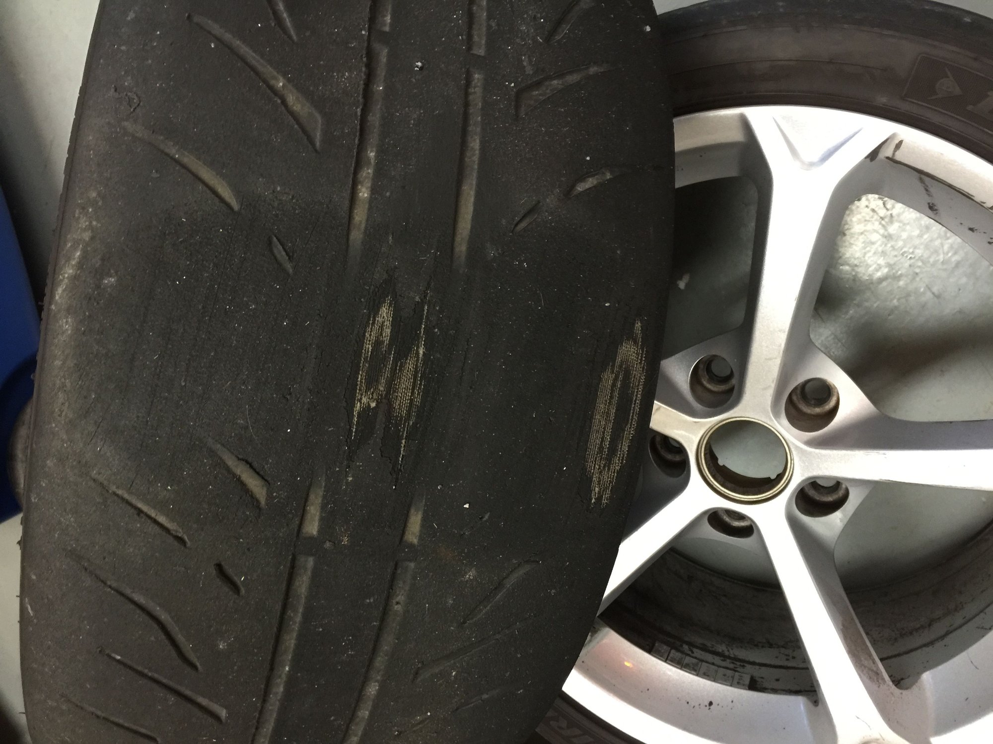

Obligatory flat spot photo:

How far did he slide? Must've been a ways. Looks like that tire was worn out anyway.

Tires were my old practice/DD tires and had about 250 autocross laps on them already, so their racing days were over. He was probably doing about 60 into a decreasing radius sweeper....he said steering suddenly became really stiff and he was heading off course, so he just dumped the anchor to be safe. We pushed the car back into the paddock, so we didn't know about the flat spotting issue till we had the alternator fixed and were driving out of the event. Thump, thump, thump, thump! We're were like "Ah, what now?"
