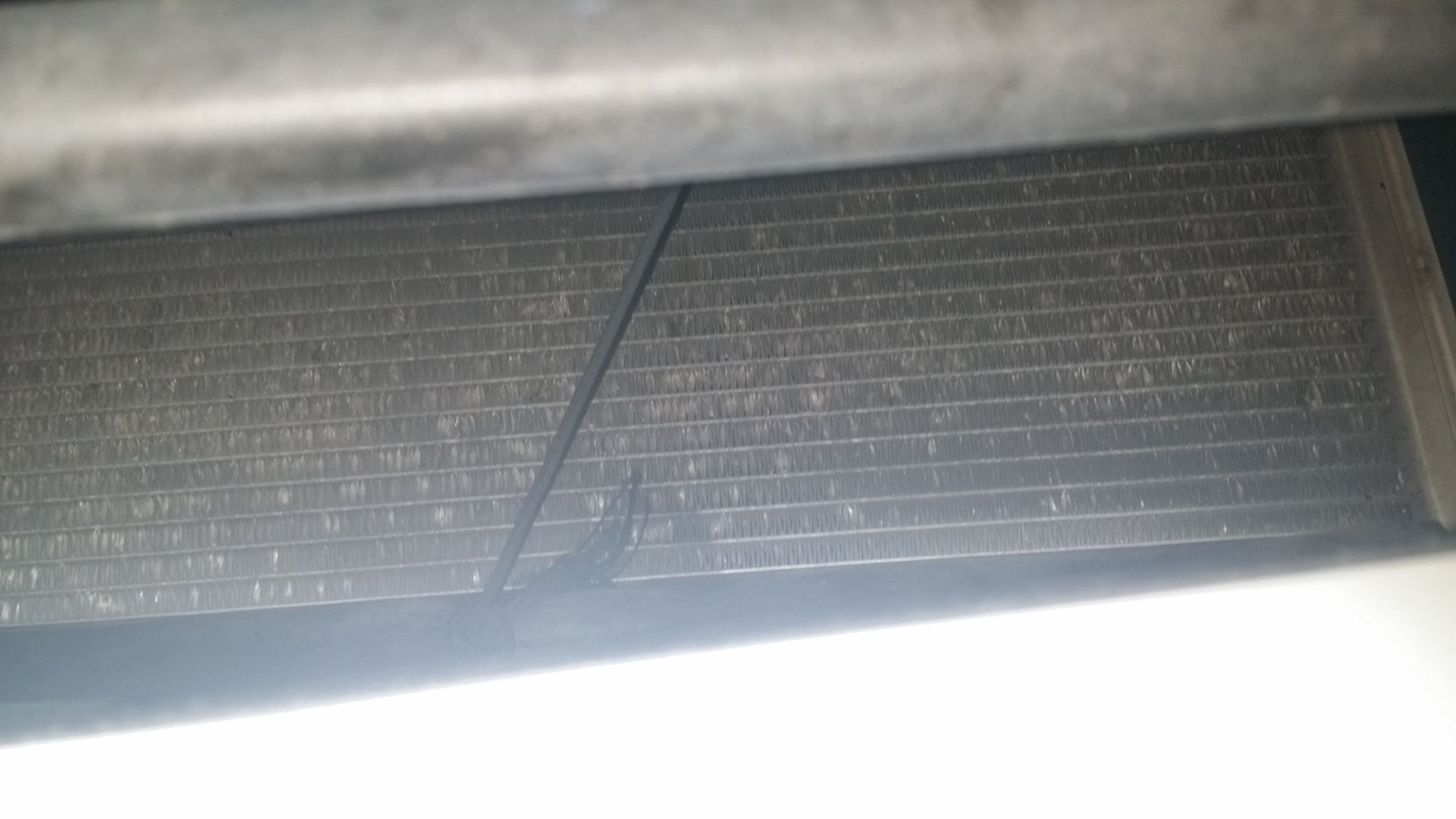

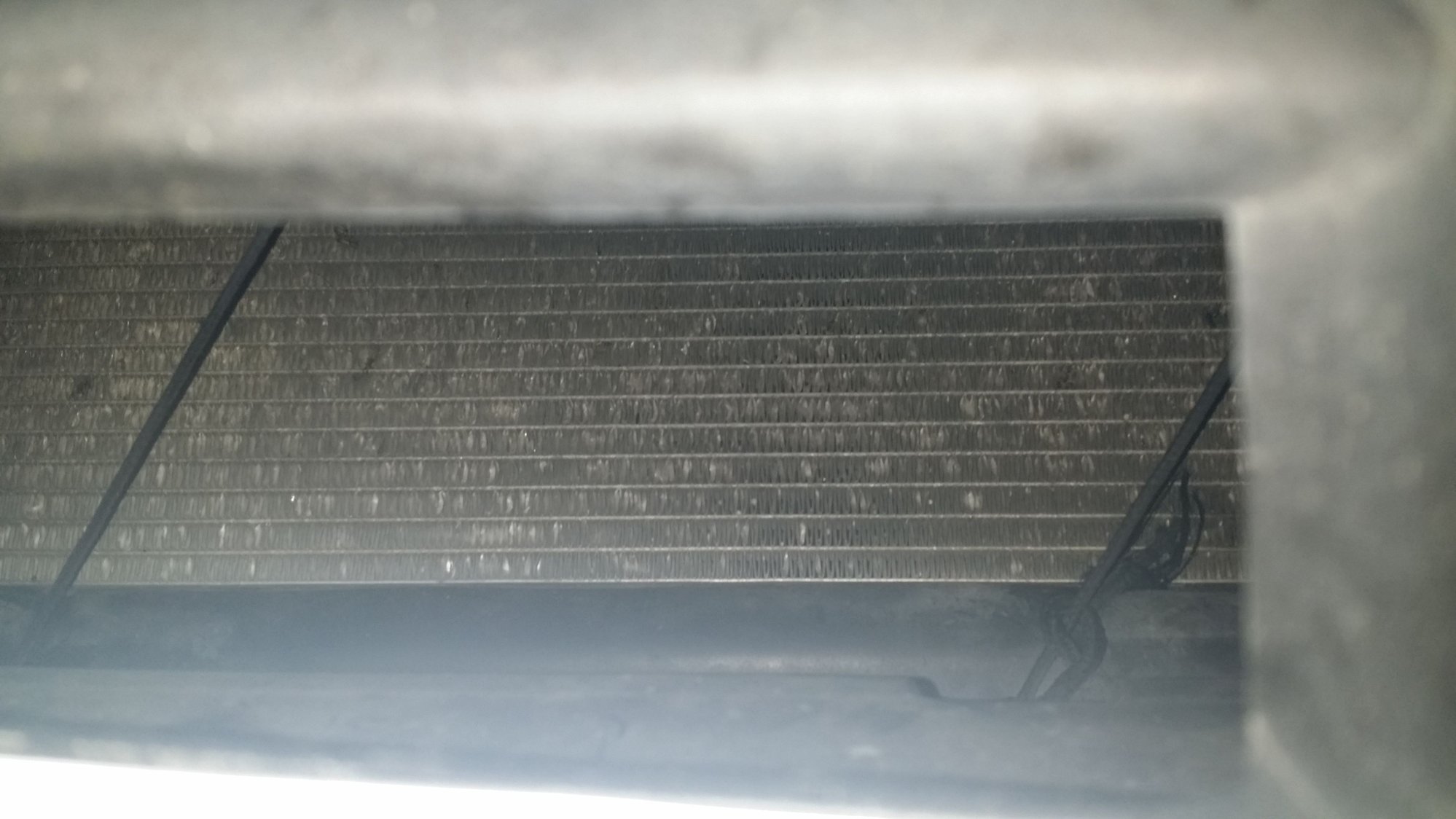

In the 100's here and mine was at 203 to 205 on the hwy at 75 mph. That has me worried. Gonna flush the radiator and condenser in the morning.

I have been working on my condenser, there are a lot of the fins bent over blocking airflow. Have a dental pic I have been using to straighten them.
Anyone know a better way?

I have a fun comb for hvac. Problem is the fins are only 1/3 of a inch long and are sandwiched between horizontal bars.
Area behind grill was about 50% blocked. Got some done but it's too dang hot now. Will get up early and do some more, then flush it with my home made wand.
My condenser looks like that, what would be the cause for them to bend over? I do use the high pressure wash at the car wash to wash it off, so maybe that is the cause??

Just bugs, sand and road debris. They take a beating, more so at speed.

Air must flow through the condenser to get to the radiator. So impaired airflow through the condenser will cause higher water temps.

Thanks" But how do you get to the condenser without removing that grill??

Reach under the front fascia. It is open in front of the air dam. The air dam deflects air up through this opening to the condenser and radiator.
I look through the grill, but work from underneath.

After you take off the intake (air bridge) and the radiator/condenser top support, you have about an inch of space to insert a water wand and spray out the condenser from the back side.
https://www.corvetteforum.com/forums...-cleaning.html
