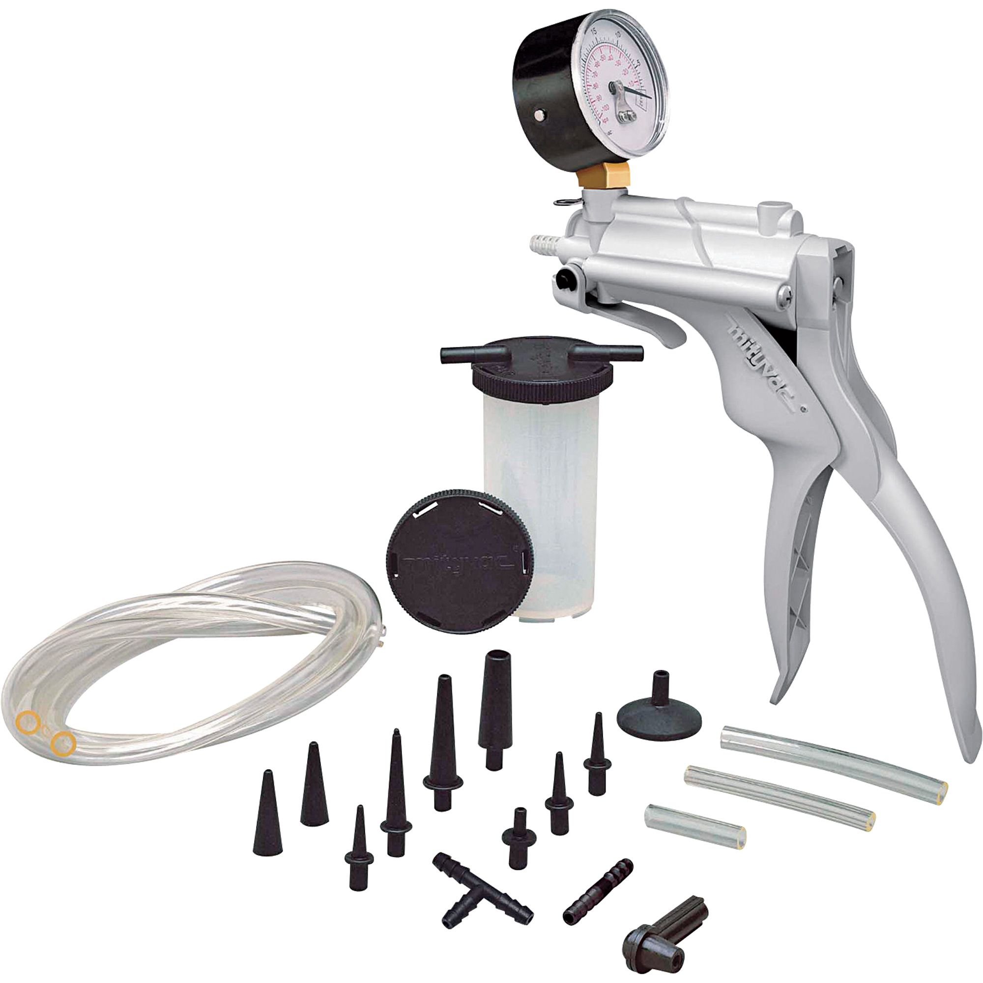

I have the professional version of the Mityvac, great tool but mine won't draw enough vacuum to bleed brakes. When I don't have a helper, I'll 7se the gravity method. Gravity works most of the time as long as the valve in the Master Cylinder is open - I think the pedal has to be absolutely at the top of its travel. I seemed to have had an issue with that once.
I'm leery of using power bleeders, brake fluid under pressure can spray into hard to clean places.

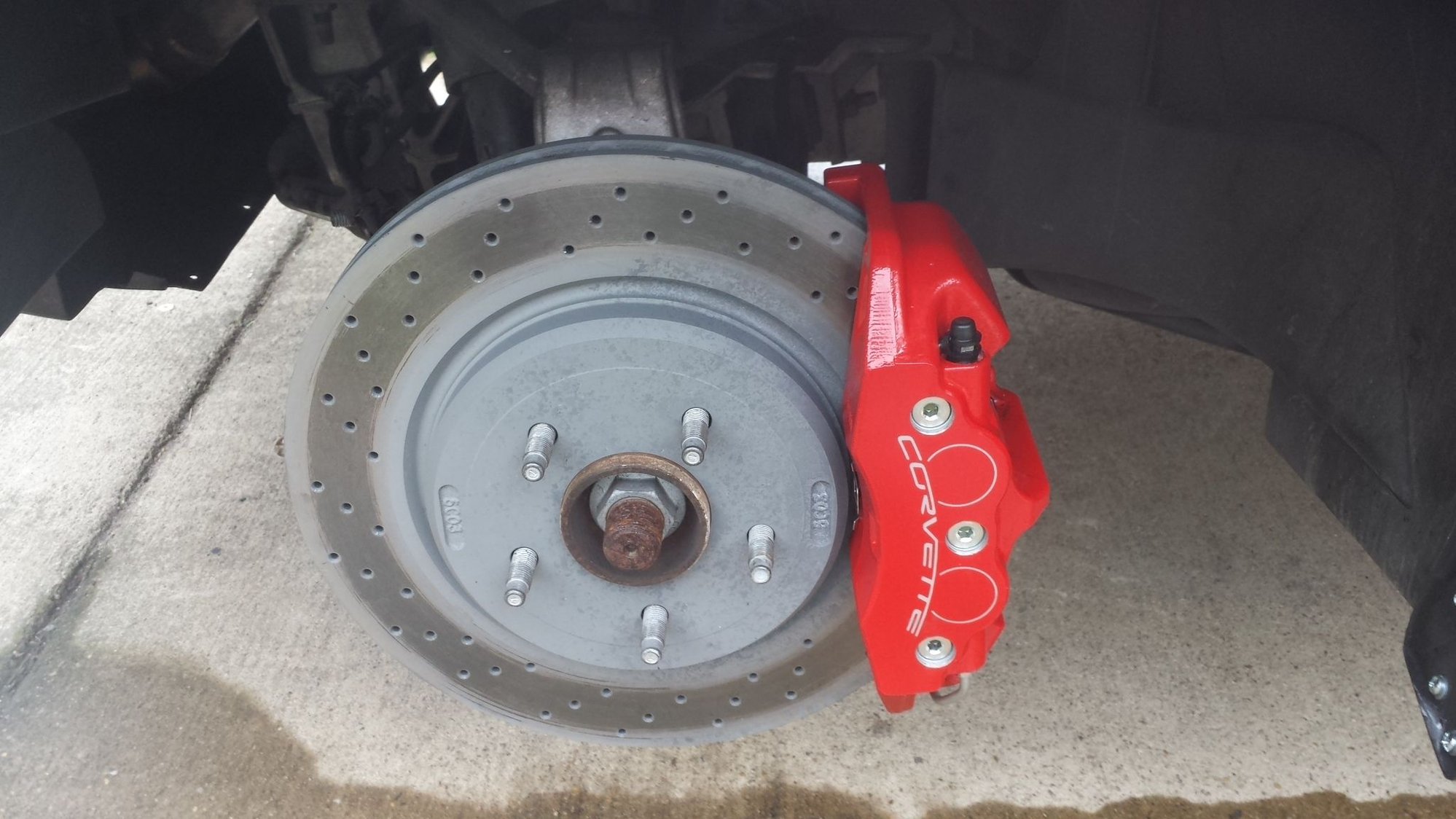

Well, swapped calipers, started bleeding, RR nice solid stream came out. LF lots of air, couldn't get solid stream. LR same. RF nice and solid.
Ran out of fluid, so right now on to see if i can find a bleeder that can pressurize the reservoir otherwise I'll continue to suck fluid off until a solid stream is achieved. I might have a loose banjo bolt. So i need to squeeze the pedal to verify.
More news as they develop. ....
Old Aug 30, 2015 | 12:19 PM
RicardoFors68's Avatar
RicardoFors68
Joined: Mar 2014
Posts: 2,321
Likes: 220
From: Woodbridge, Virginia
Ok, so now i seem to have a good pedal! Bled the brakes twice, pumped the pedal and found a leaky banjo bolt. Replaced the crush washers and gave it the ol' german torque. Bled again and this time nice steady stream of fluid. Started the car, put it in drive and took it to 10mph then squeezed the brake pedal. Did this twice more. Bled the brakes again and got even more air, especially the front left and right rear circuit.
Pumped the pedal, nice and stiff like if i used viagra on the fluid! Tightened that pesky banjo bolt again, no apparent leaks.
1. Re installed the calipers in their correct side, bleed screws facing up
2. Ensured all banjo bolts, hose connections, are straight and tight
3. Seems like i was able to energize the ABS solenoids and allow more air out of the brake system when i put it in gear and then pushed the brake pedal.
4. You can't never have enough brake fluid.....
5. Used a air compressor assisted vacuum brake bleeder
6. Cranked the bleeder screw no more than a 1/4 of a turn otherwise air will get in the system.
I'll check again before bringing the car down. Also wanted to wash the engine compartment before taking to the tuner, i can appreciate a clean working environment. ...
More news later on. Thank you guys for point4me in the right direction! !

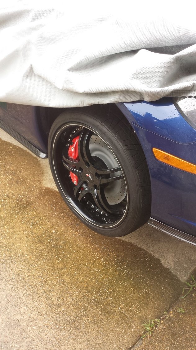

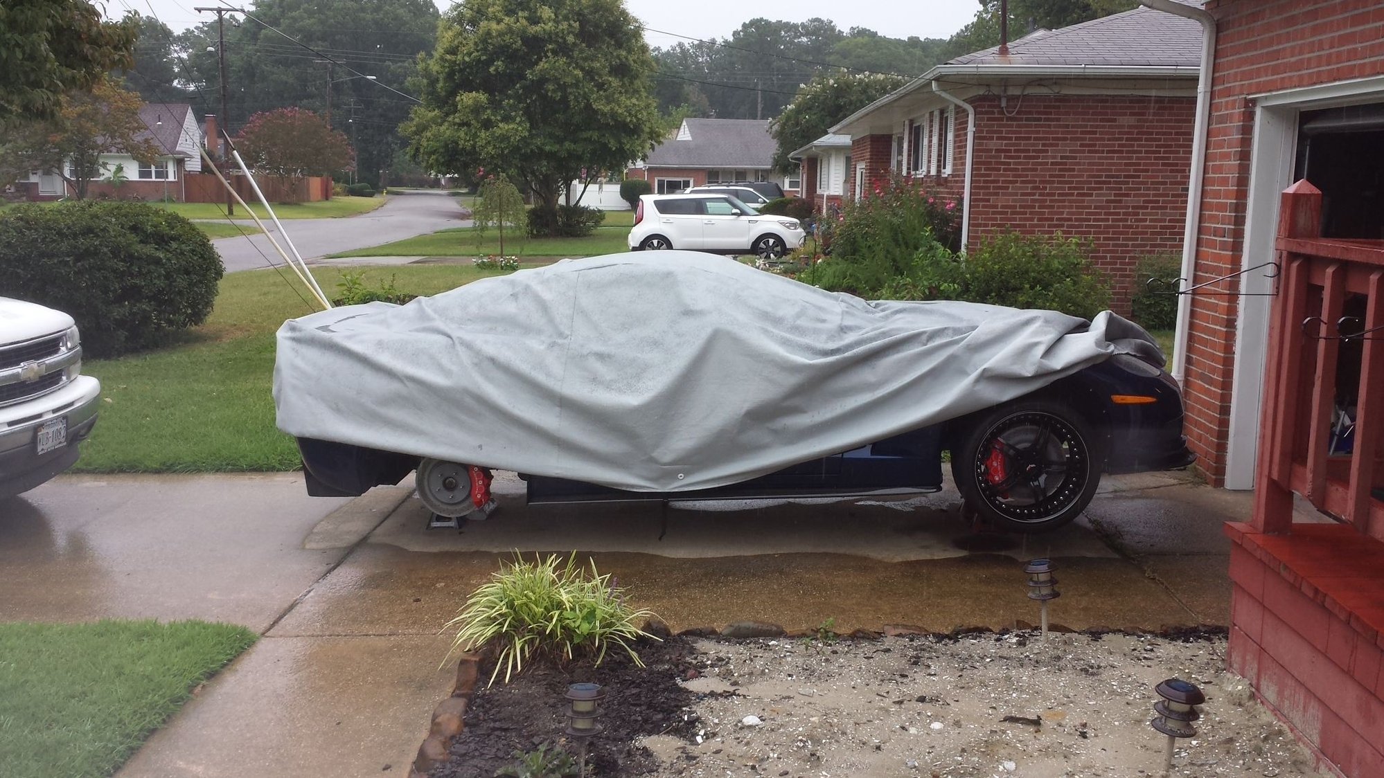

Woke up to rain so my efforts have been reduced to installing two wheels... this needs to stop so that i can road rest and re bleed...

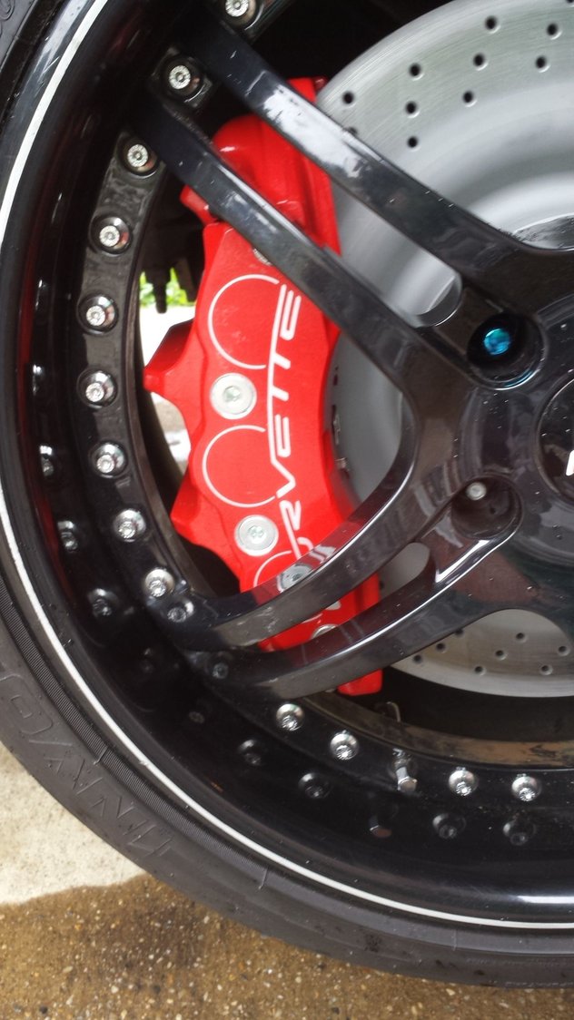

The rotos look good. Did u also painted the rotor hats and edges? What paint did u use? I need to do this. But I am waiting until I get my calipers powder coated too
