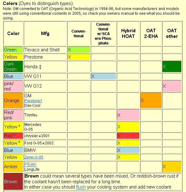

Pink is coolant. If there is a puddle then it should be easy to find the leak. Typical in order of seriousness would be hose or water pump or radiator.

What brand of coolant is pink?
Mine is GM - Orange. Most is florescent greenish yellow.
Pink - I would look for Power steering and ATF.

Alrighty then, I got a look at the puddle, soaked up some with a paper towel and it's definitely pink. I used an eyedropper and sucked up enough to put into a small cup. It's without a doubt pink. I had some Dexcool and poured out a small amount and it's orange. Next move, I sucked up some from the coolant tank and it's pink. This car was bought used about a year ago with only 18K miles on it. Someone before me might have messed with it. It's hard to pinpoint where it's coming from. Its off to the doctor Monday unless I can get a better look at it this weekend. For now, I'm bummed.
