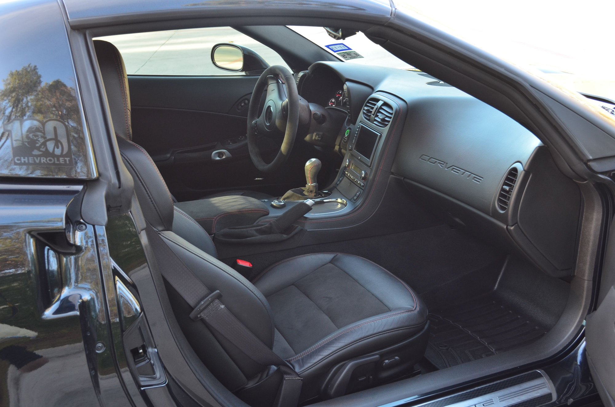

Plus the Centennial Edition was available:
Chevrolet Centennial Special Edition commemorates Chevrolet’s 100th anniversary
* Carbon Flash Metallic exterior color (Special paint only used for C6 Centennial Edition Corvettes in year 2012!)
* Special Chevrolet Centennial Black wheels (specific to model) with special center cap logos
* Satin Black graphics
* Magnetic Selective Ride Control
* Red brake calipers
* Special badging
* Suede seats with Red stitching (only for Centennial edition Corvettes)
* Seat embossment, steering wheel badge and special interior trim plate
Nothing improved from a performance or handling stand point...
But the interior on the Centennial is real nice....
