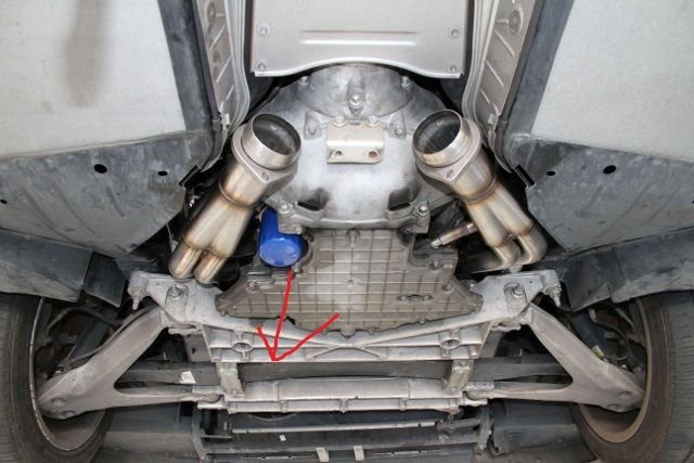

Dropped a Spark Plug Socket down between the engine and the leaf spring. It is stuck good right in the middle of the leaf spring and engine, can't move the socket at all. Is there a way to get this thing out of there? Will it just fall out while driving? What is the best way to release some tension off the spring?

I did jack it up and I can feel the socket. It is really stuck in there. I am thinking I have to loosen or remove the leaf spring.
Stuck right here.
Picture isn't my car, but that is where it is.

The very same happened to me in exactly the way you described it and in the exact location. I had to jack it up and still took me 30 minutes to move it pull it to get it off, scratched the spring a little bit but better than leaving there as it might have caused more damage to the spring as the suspension traveled up and down while driving. I suggest you do not leave it there, remove it any way you can.

Some good suggestions were offered. I personally would get it out, by whatever means that it takes. I also dropped a socket in the same place, and getting it out was hard, but doable. I had my car jacked up pretty high at the time, and it was still difficult to get anything in there.

I agree with the rest. Get it out. It would eventually fall out, but it would probably end up in someones windshield too.
Try jacking up the car then getting something under the tires to make the spring flex the other way a little.
If you have to completely remove the spring you'll need to disconnect the shocks and upper control arms before unbolting the spring holder bracket.

Why not jack up the car and put it on jack stands, remove the two bottom engine mount nuts and put a jack under the engine oil pan (of coarse put a piece of wood between the jack and oil pan)lift the engine 1/4-1/2 inch and used a magnet to remove the socket.

You need to try jacking the car some way to allow the spring to flex so that some clearance is added. Try jacking from beneath the A-arm on one side or the other or from under the cross member (to allow both sides of suspension to droop). Use hockey pucks or wood squares on the jack saddle to avoid any damage to the suspension members.

Maybe jack it at the puck location one side, go real high maybe the flex will loosen it, Murphy's law indeed
