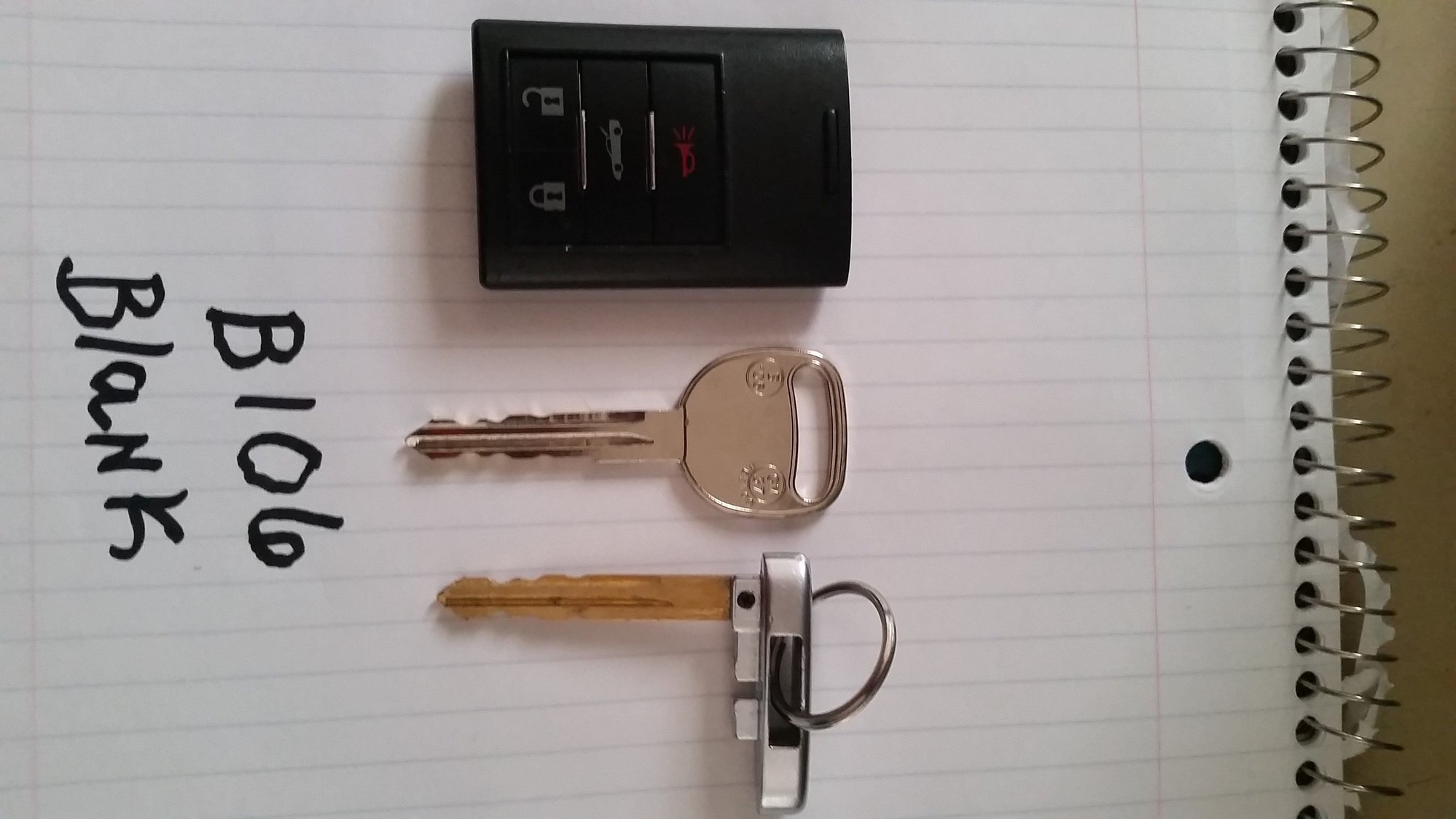

That happens more than you would think so one in wallet and one under car.
Key made on B106
Luck
