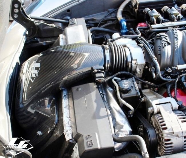

Here's another real CAI to add to the discussion.
I'm very happy with my VaraRam and have more than a little rain to contend with.
Stay out of the puddles and use some common sense.
Any intake, including stock, can allow an engine to become hydro-locked if you hit the front end with enough water. (posted on the Forum)
It's posts like that one, that tell me I'm smart enough to run a VaraRam.
YMMV

CAI = COLD Air Intake. COLD meaning not underhood air.
See the pics to find where the COLD air enters.
http://vararam.com/sc1.html
