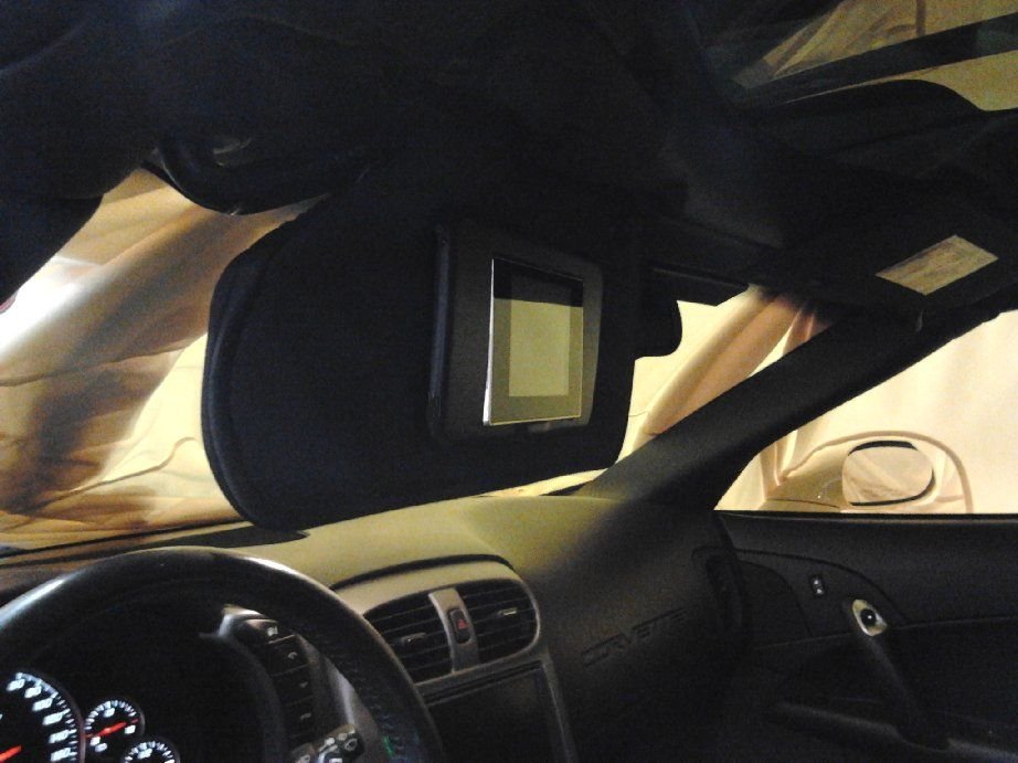

I went another route and added a monitor inside the driver sunvisor where the vanity mirror used to be. It's stealth, can't be seen, and easy to access when the camera view is needed.
I use my monitor for a front facing camera for parking. The camera is mounted on top of the center air dam, just below the radiator.
