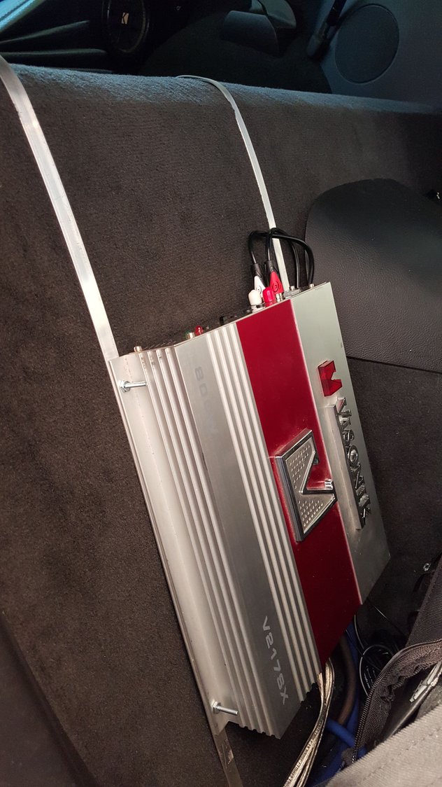

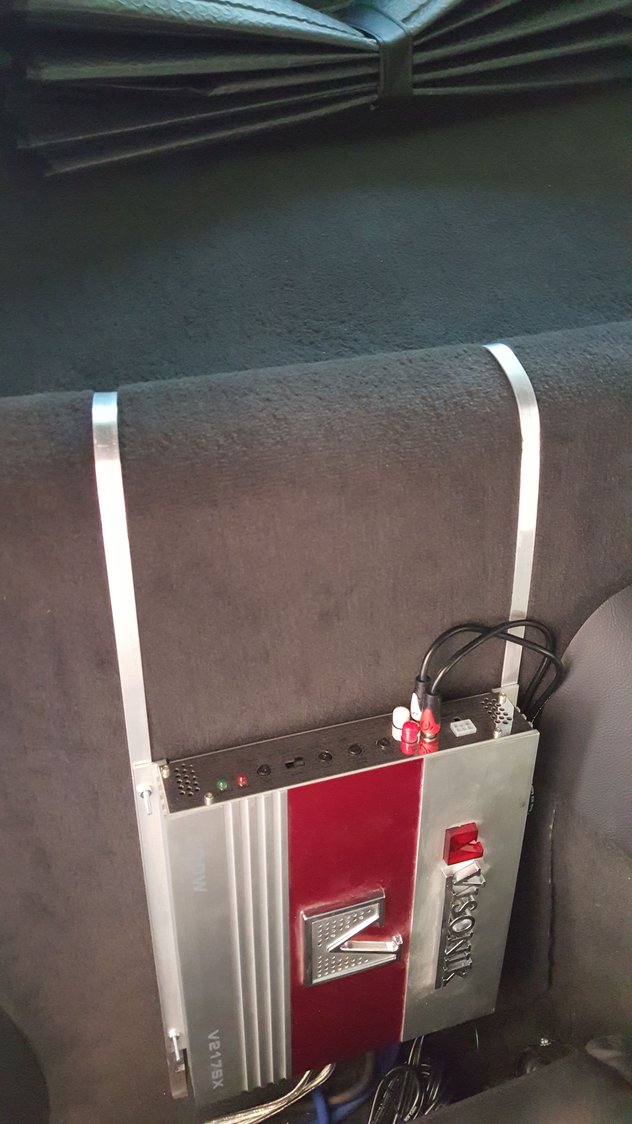

On the surface behind the seat.
All I bought was two pieces of 3' long aluminum bar stock, usually in the same aisle as the bolts and screws.
A small pack of bolts and nuts that fit the holes of the amp.
Once I got it all put together, I just bent the barstock behind the carpet on the back.
I just took some quick pictures, if you need more just let me know.

Oh ok yeah man that's smart think real good idea I'll probably do that... Thanks for the info. No need for more pics those were perfect man.
