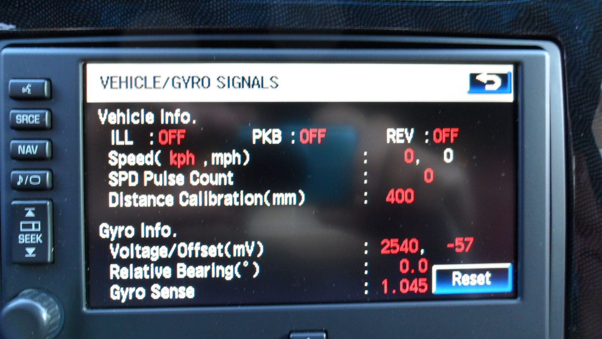

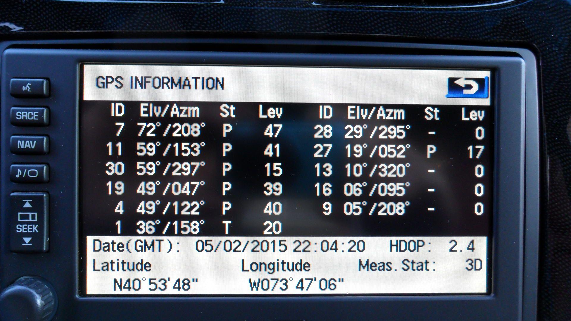

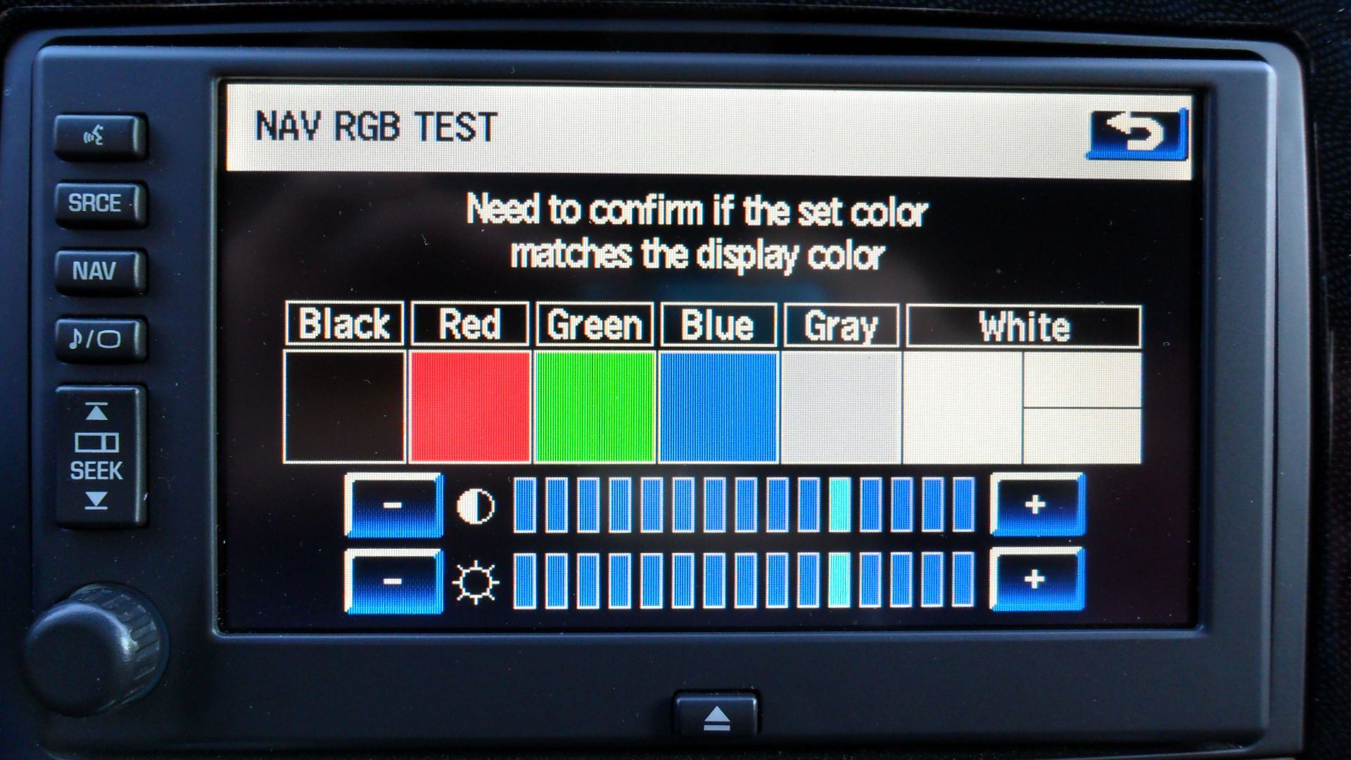

So you bought a new Tech 2 for $250-$300 to make it do a $100 job? Now with a little ingenuity right from the radio you can make the radio go into these screens and diagnostics:
while interesting to look at none of those screens will allow you to unlock the radio.

I never said they would. Just some cool things the radio can do on it's own. You don't need a Tech 2 to get into those screens, the radio does it on it's own.
