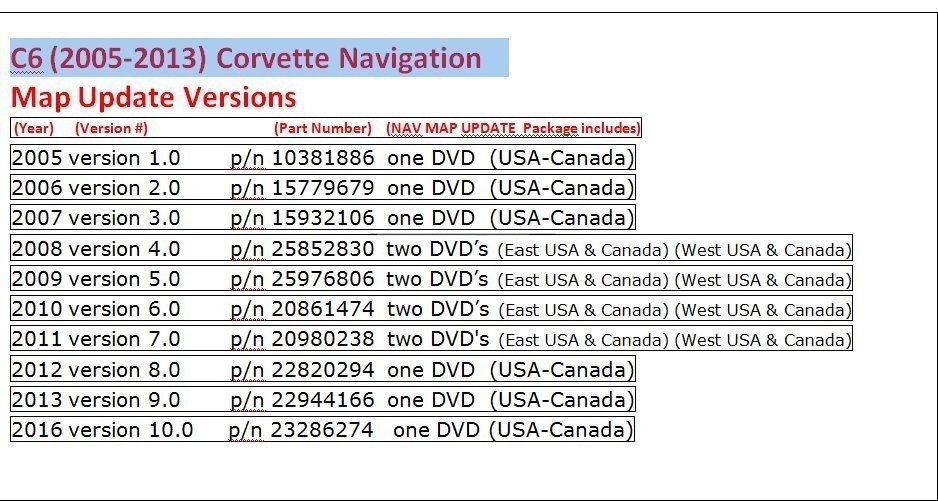

The newest version 10 for 2016 just came out.
Here is the versions from 2005-2013
The GM Nav DVD's listed are for the C6 Corvette, but they are also compatible for the 2005-2011 Cadillac STS, but they may need a software update.
It's best to get a NAV DVD that is for the Corvette as per the part number/version. Get the latest version possible.
If your NAV unit has not been used in a long time, the heads could be dirty, hence why you are getting insert disc. Run a DVD cleaner disk then retry your NAV DVD, and hopefully it will load up.
BTW, the disk has to stay in the Nav unit at all times while using it.
