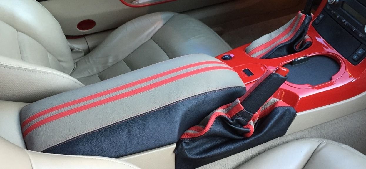

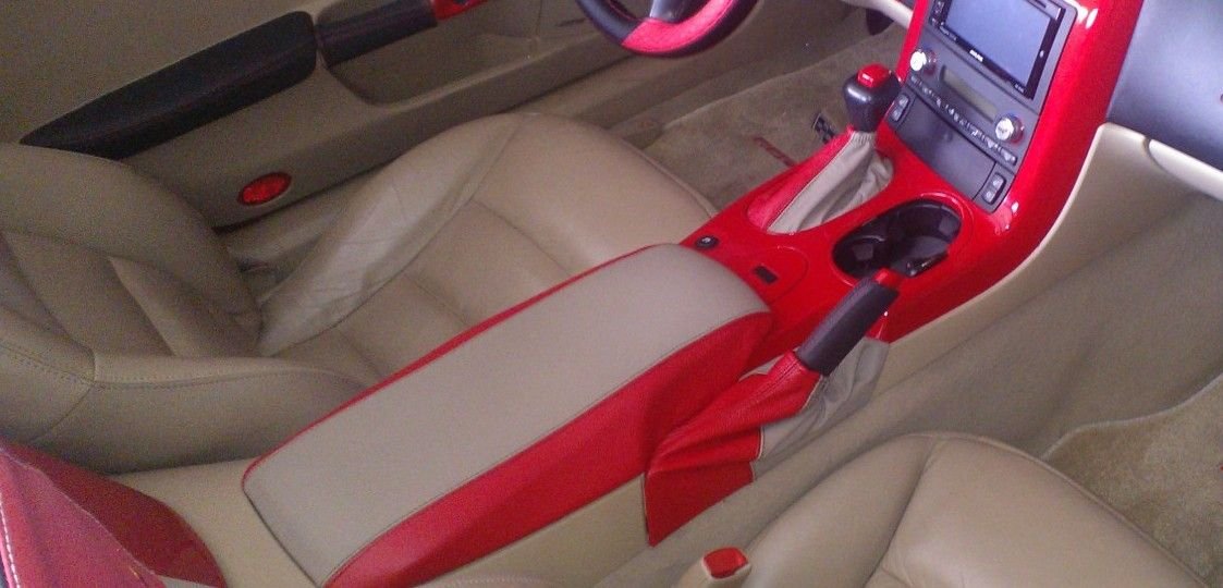

I've changed them out a few times and purchased from redline goods. Lot's of instructions available and pretty easy to do.
They were black to start then I changed them out to these
Then changed it to this
And then changed the center console again.
To 2007 automatic shift boot
