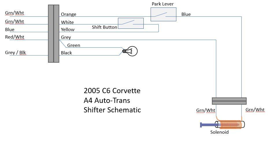

I have been hunting for that switch as well. Many threads have folks bypassing all sorts of electrical and mechanical stuff, but with my '05 C6 A4 Trans, this little microswitch is stealing all the power that is intended for the solenoid. Here's a schematic that I reverse engineered ...
In the picture below, the Meter is reading over 300 ohms when it should be (ideally) a dead short. This is why the Solenoid doesn't have enough power to energize. Depending on how hard I pushed/deformed the lever, I could get over 1000 ohms. It's not your battery. It's this little switch that is keeping us all stuck in park. (the other microswitch, without my finger on it, is not directly involved in this circuit)
I haven't taken the switch apart to clean it yet, but if I can't find a new one, that might be my only hope.

I'm cross posting this across the dozen or so threads I have found about this problem with the '05 C6 A4 being stuck in park.
That little microswitch is the culprit. It should go from open-circuit to short when activated. Mine is all over the place. It either needs to be replaced or cleaned.

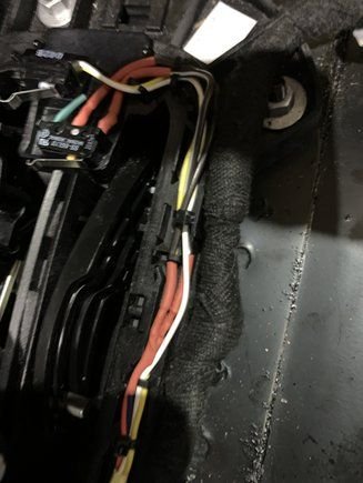

I have all the info now to do this fix and understanding of the failure. I think one thing you missed to mention was if you needed to do the same to the 2nd switch? Because I'm thinking since I have it opened up like this, I might as well replace both, or I shouldn't?
Below is the picture you posted and you only replaced the switch with the red heat shrink on it. So basically my question is if you replaced the switch that is sitting right behind it, visible in your picture.

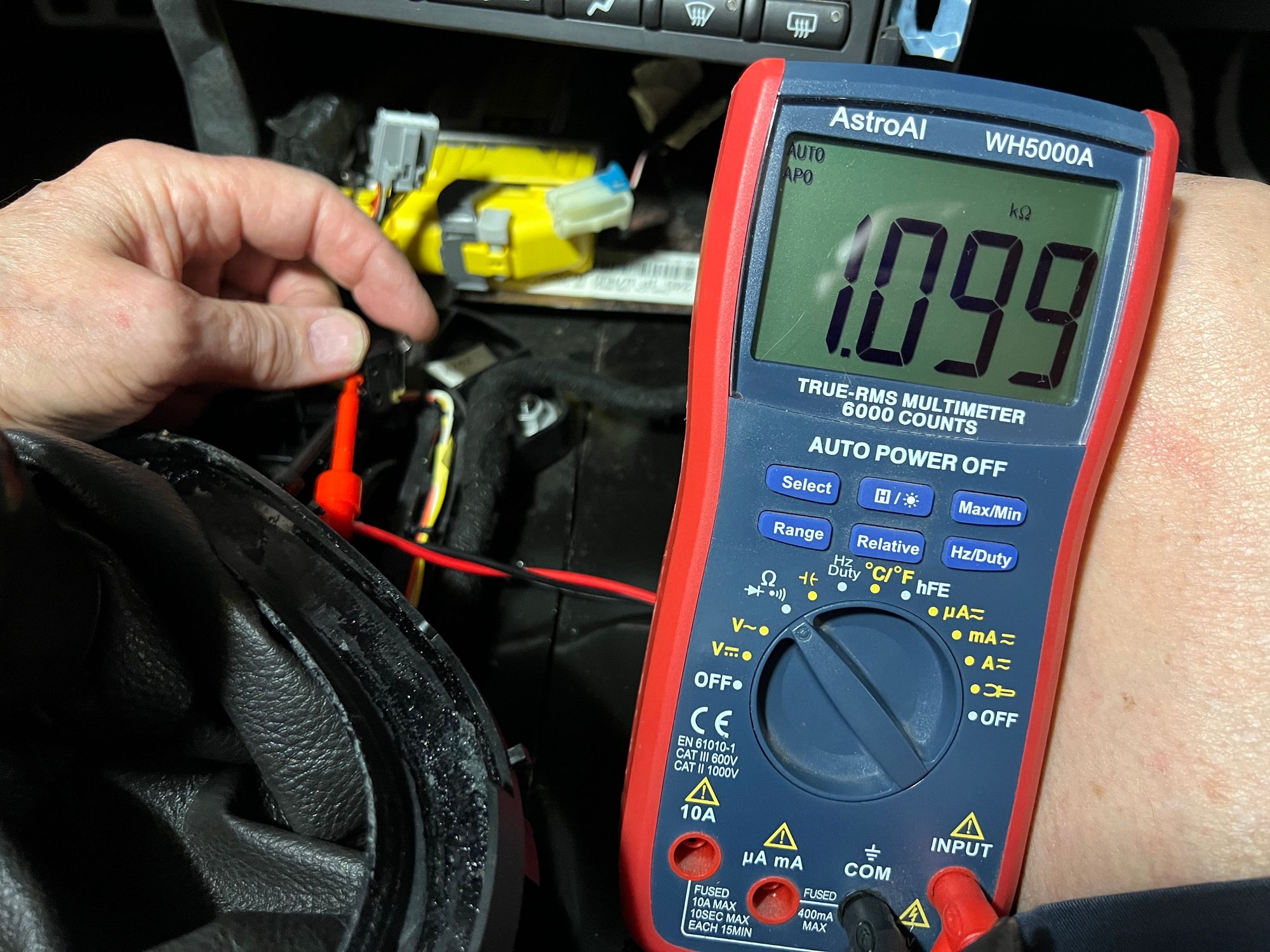

Just a minor update, some posts suggest cutting the switch wires and splicing in new longer wires. I found that the little plastic cover on the bottom of the original micro-switches can be popped off with a small flat blade screwdriver. This exposes the soldered connections. Wires can be unsoldered easily leaving plenty of length to solder them back on to the new switch. Worked for me

Here is the original micro-switch before wires unsoldered. You can see the bottom plastic cover has been pried off. This switch measured 1099 ohms when closed
