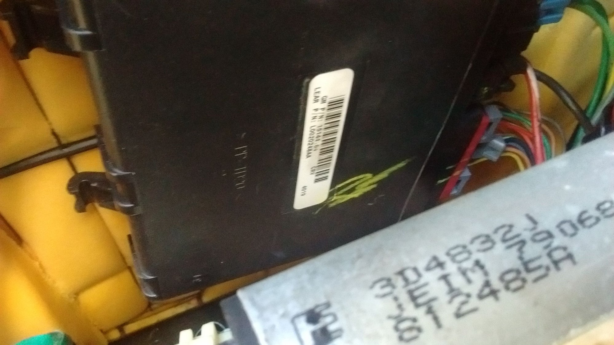

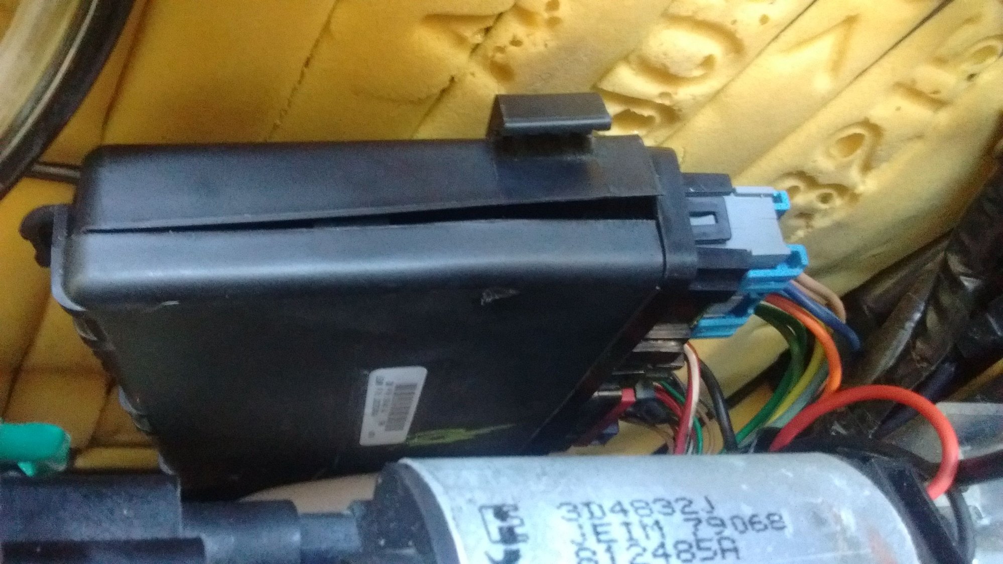

Originally Posted by LCSteve
I would agree with this almost 100% of the time except I only use Fob#1 in my car and roughly 1 in 5 times I get in my car the seat just seems to go where ever it feels like. Sometimes it goes so far forward I think it's trying to kill me (I'm 6'4") but most of the time it works A-OK. I spent weeks trying to figure out the rhyme or reason like if I adjust my seat while driving or resetting my seat memory and even pulling the battery out. I'm just getting use to my seat kinda doing it's thing. Personally I think it has something to do with the wiring harness under my seat as it's a little chewed up from the seat action before i bought it. I've since done the zip tie fix and have an appointment scheduled with the dealer for the recall.
Had the same problem with the seat moving by itself. The problem is that the module under the driver seat tends to get distorted whenever you sit on the seat or adjust your position. To correct the problem simply take the control box loose from the seat springs, rotate it 180 degrees, and let it lay on the floor. Just make sure that it is behind the power seat motor.
There are two clips on the front and one on each side which fasten over the seat springs. The second pic shows what had happened to mine. It still works perfectly now.
