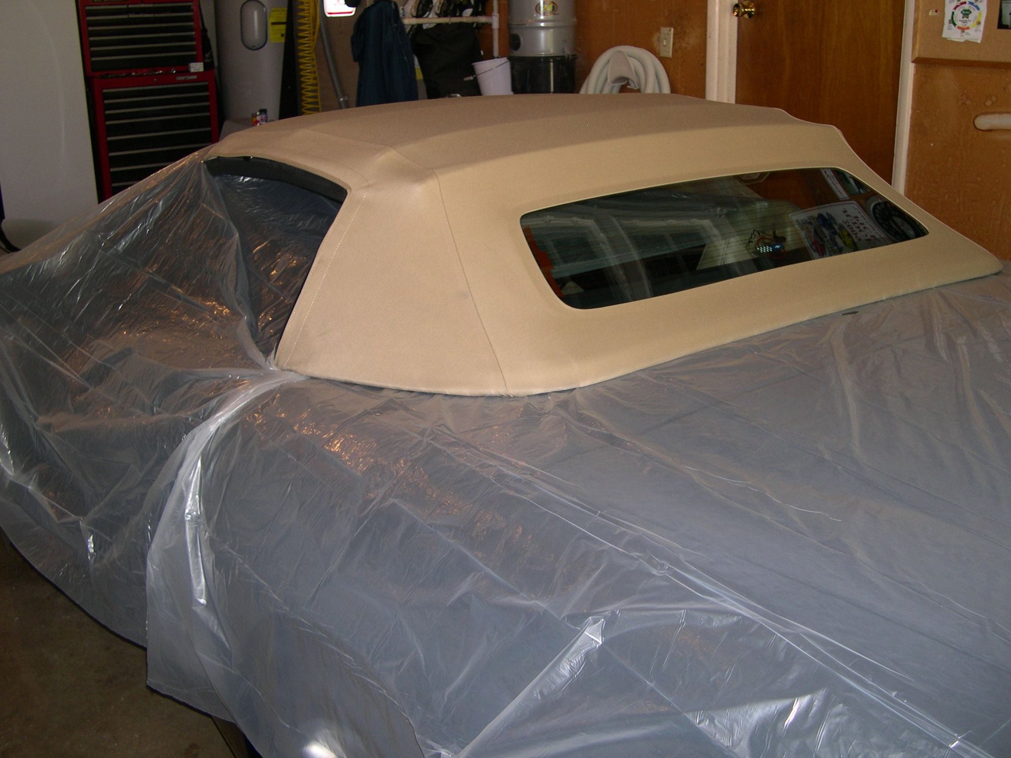

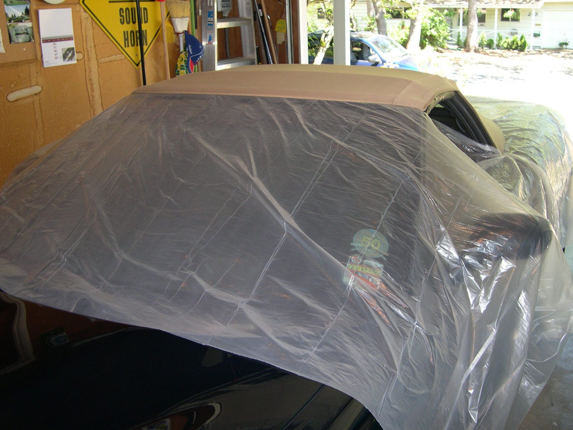

I find it much easier to cover the glass and paint with some sheets/towels. The over spray gets everywhere and is a pain to clean up. but that's just my experience. (I tape off the rear window and cover with a couple sheets of paper)

This was on our previous C5, but the photos show how I deal with the over-spray.

You can buy the 3-pak of paint drop plastic, about 9'x10' I think, for a couple of dollars. Follow the pictures above, clean, let it dry, place the plastic/mask off the rear window and then apply the treatment. I use Raggtop but have used Aero on other verts I have had.
Don't forget to use some silicone grease on the rubbers seals. Should be some posts here. I started using back when I had a S2000. Apply and then wipe-off.

I have had no issue with overspray. I wipe it off the paint and glass as soon as I coat the top. Never had issues with difficulty removing the residue.
