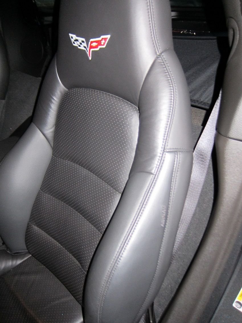

I replaced the upper seat backs in an '09 with side airbag. Seats in the car, top removed for more access, and battery disconnected. You will not be disturbing the airbag, just remove battery connection. You should have a staple gun to repair this. I replaced the plain stock cover with optional cross flags.
The lower cushion, needs a ring plier, and the seats need to be removed. There is a video on you tube showing the removal and replacing of the upper and lower covers.
I put these upper covers on by myself...
