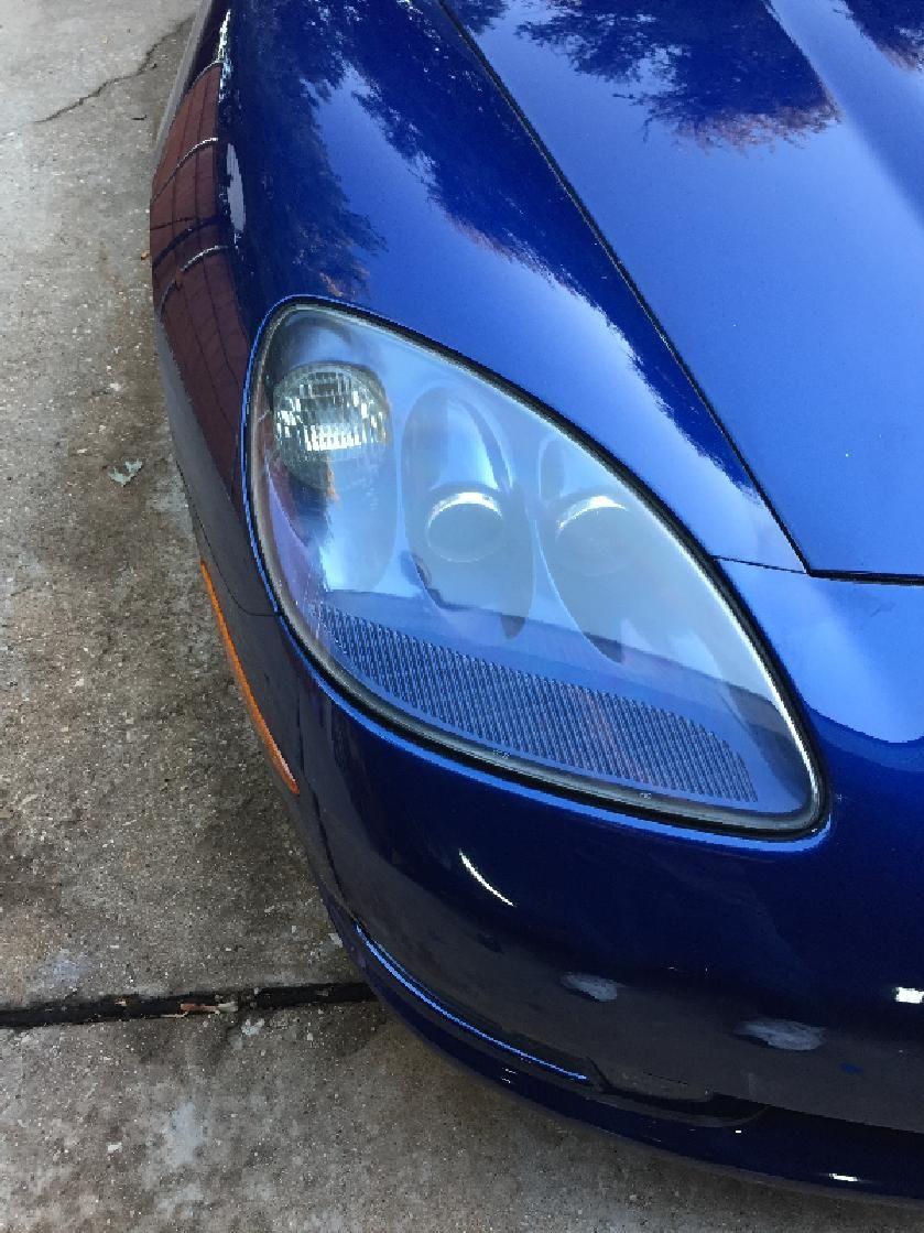

I'll be removing these soon for halos and plan on painting the buckets black.

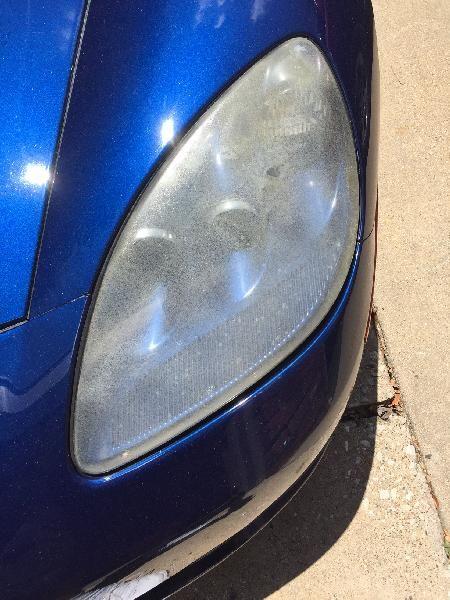

I spent a couple hours each on these, guess I didn't take near enough off.

As mentioned, the crazing may be so embedded in the lenses that if you sand it out, your lenses will be nothing but air. Here's hoping you get lucky.
I'm not sure how you can determine the thickness of the remaining plastic except to look carefully and make an educated guess. Currently, your car may look a bit goofy but it's perfectly drivable during day and marginally at night.
Since we don't know when/if replacement lenses will be available, I'd be ready with a "Plan B" (new lights/used lights/park it) if you destroy the lenses.
Best of luck to you, and thanks for keeping us posted.
