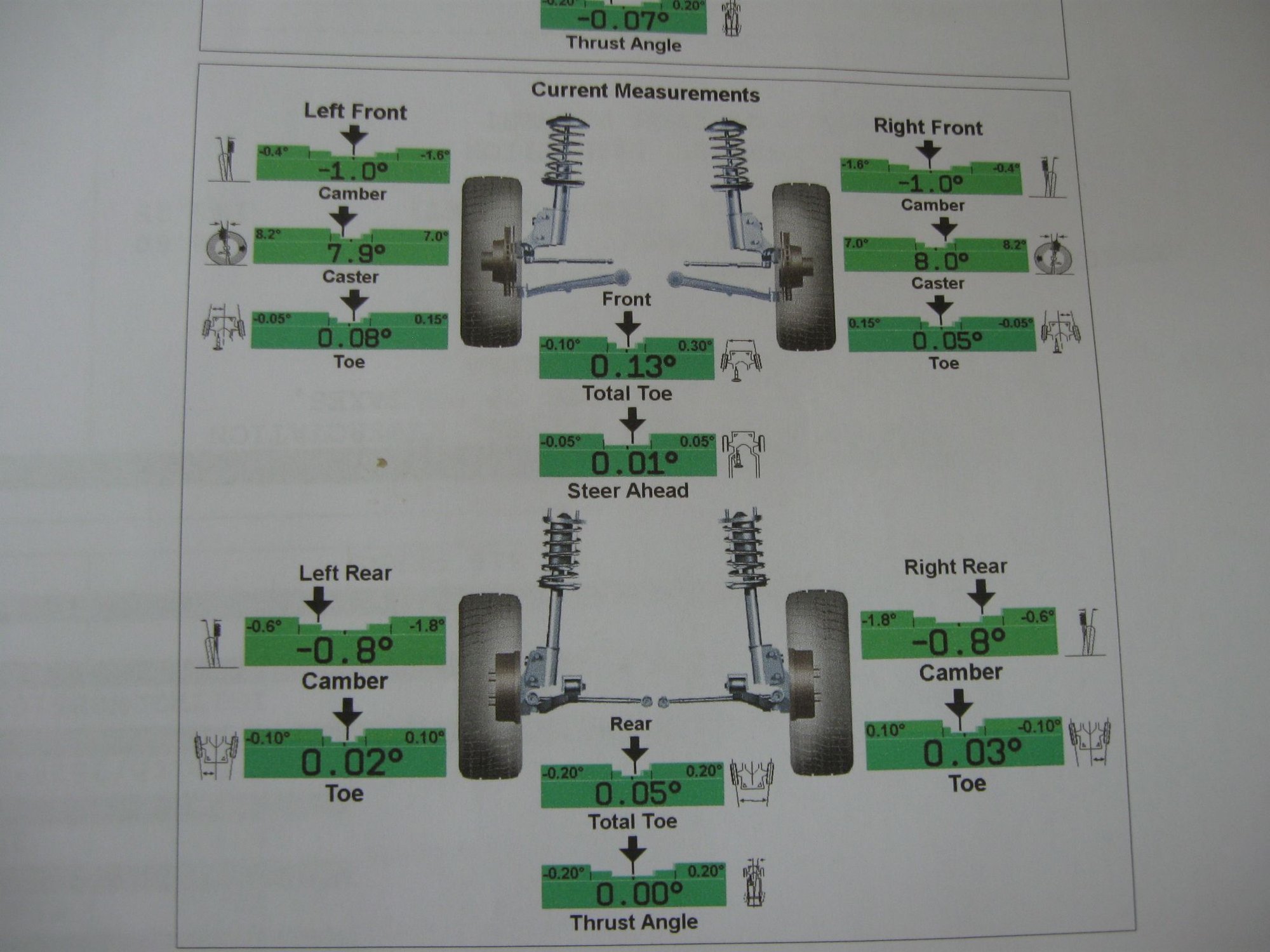

I checked what mine were set at, very close to PfADTS except for "toe", They have it at 0.0 mine is at 0.08-0.05 front and rear at 0.02-0.03
Do you not have to have some "toe" to prevent wandering or tramling ??
NSF
NSF
In some versions of the PFADT street specs, IIRC the remarks section does call for a very slight amount of toe-in. They call toe-IN as a negative number but all alignment machines I've had used, show toe-IN as a positive number. I have mine set with very slight toe-IN and it's fine.
Toe-OUT is not nice; it makes the car twitchy and wears the inside edges of your tires. I think only an over-caffeinated autocrosser would want toe-out.

So here is my last alignment done by our dealer, seems to be in line with PFADTs for the most part
NSF
NSF
For me, that looks darned near perfect.
Old Sep 22, 2016 | 07:53 PM
Boomer111's Avatar
Boomer111
Joined: Oct 2005
Posts: 14,999
Likes: 200
From: Bay Area Ca.
Too much front total toe.
Toe is what scrubs the tire for wear.
Keep the front total under .05
Camber is a wee high to for street and best wear characteristics, both front and back.
But in all acceptable, watch for wear.
Comparing to PFadt street specs.
I run their specs exactly and wear is very even.
