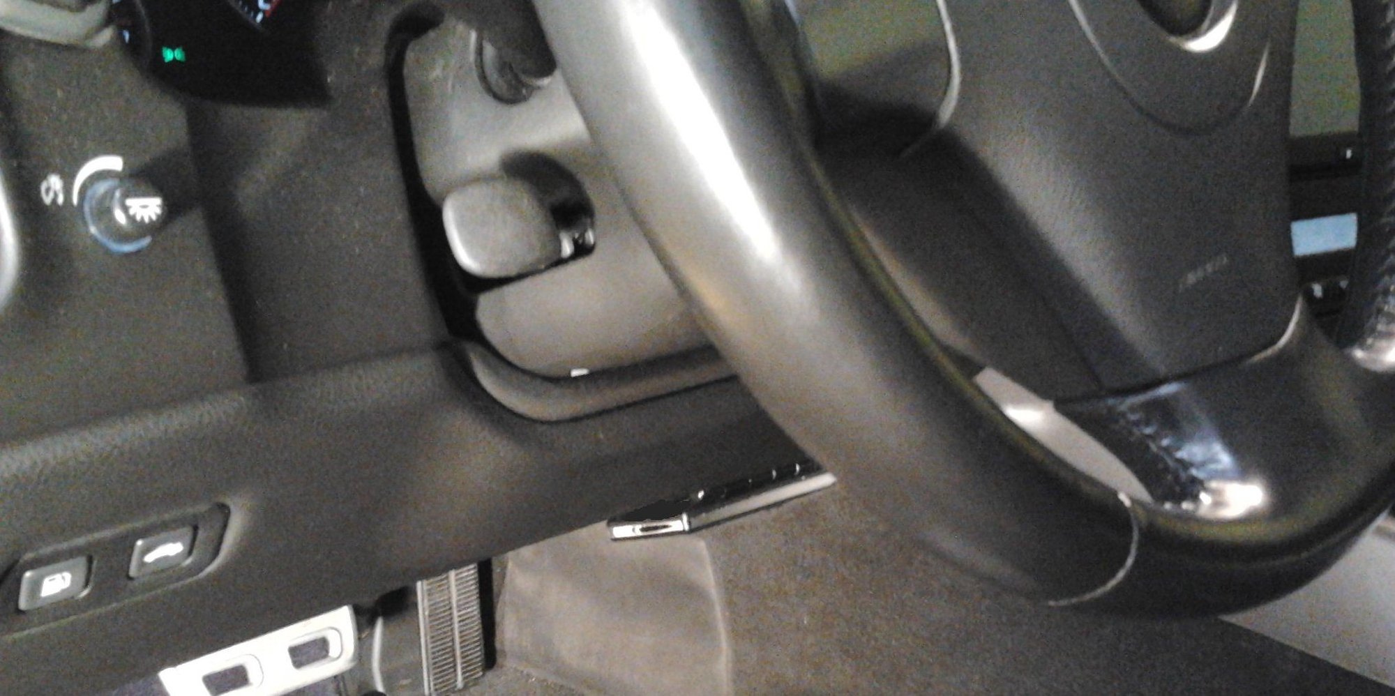

I also have the OEM NAV and did not want to change it out, and since lockpick 360 was no longer available for the OEM Nav to integrate a BU camera, I came up with 2 solutions, one of which is hidden in the driver sunvisor, and one that is foldable so it is hidden of sorts.
I did the foldable solution first, but then jumped in and installed the monitor in the sunvisor in place of the vanity mirror.
Here are the pics of both.
Folding solution
Inserted in sunvisor

I can't recall exactly which monitor it was, but it was cheap on e-bay. 4.7" monitor. It had a stand for the monitor, but I removed the back of the monitor cover, and cut off the bubble that had the stand attached so it would sit flush inside the visor. I just taped over the hole in the back cover with duct tape.
I used the vanity mirror cover, cut the hole the size of the monitor, and attached the cover/monitor inside the sunvisor. It was one of my winter projects years ago.
I have a PDF of most of that project if interested. PM me your e-mail and I can send it to you.
