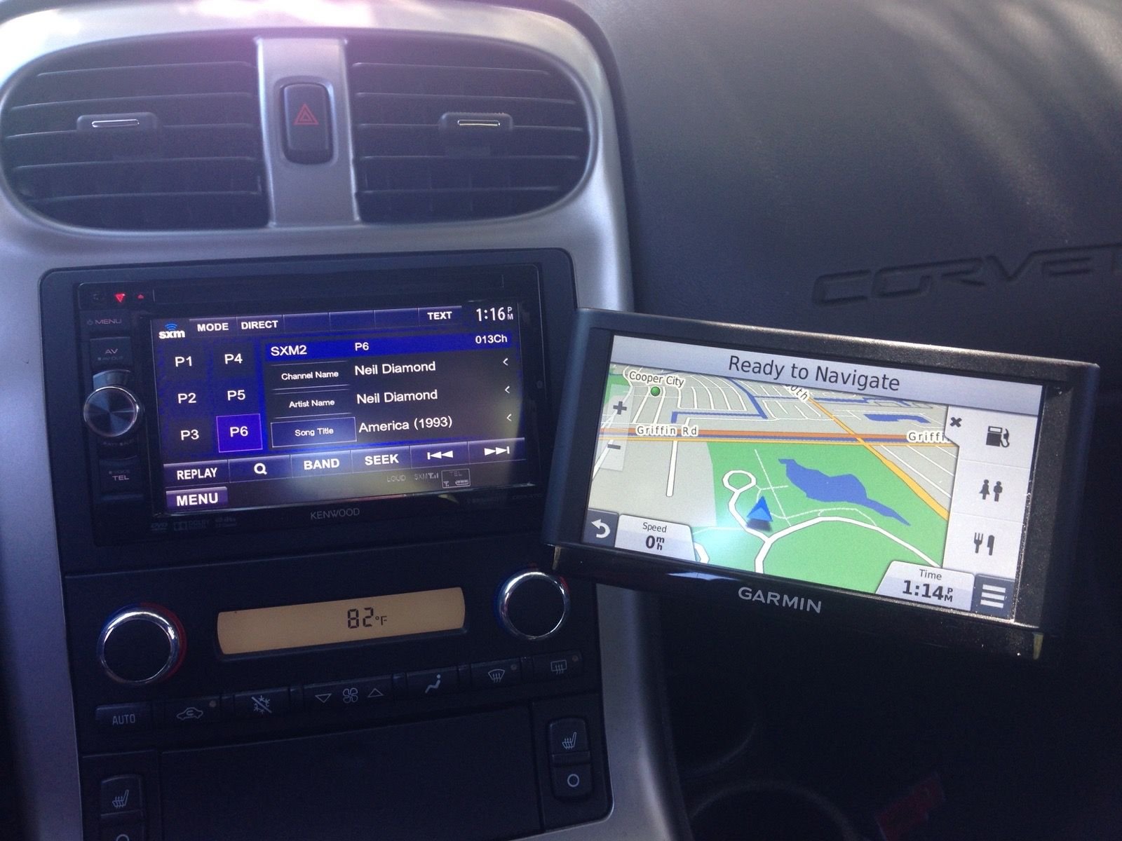

Installed Kenwood, along with Sirius receiver, it's had bluetooth for Iphone and iPods. It also plays DVD and along with host of other options.
I use my Garmin for Nav, which is easy to update software maps.
