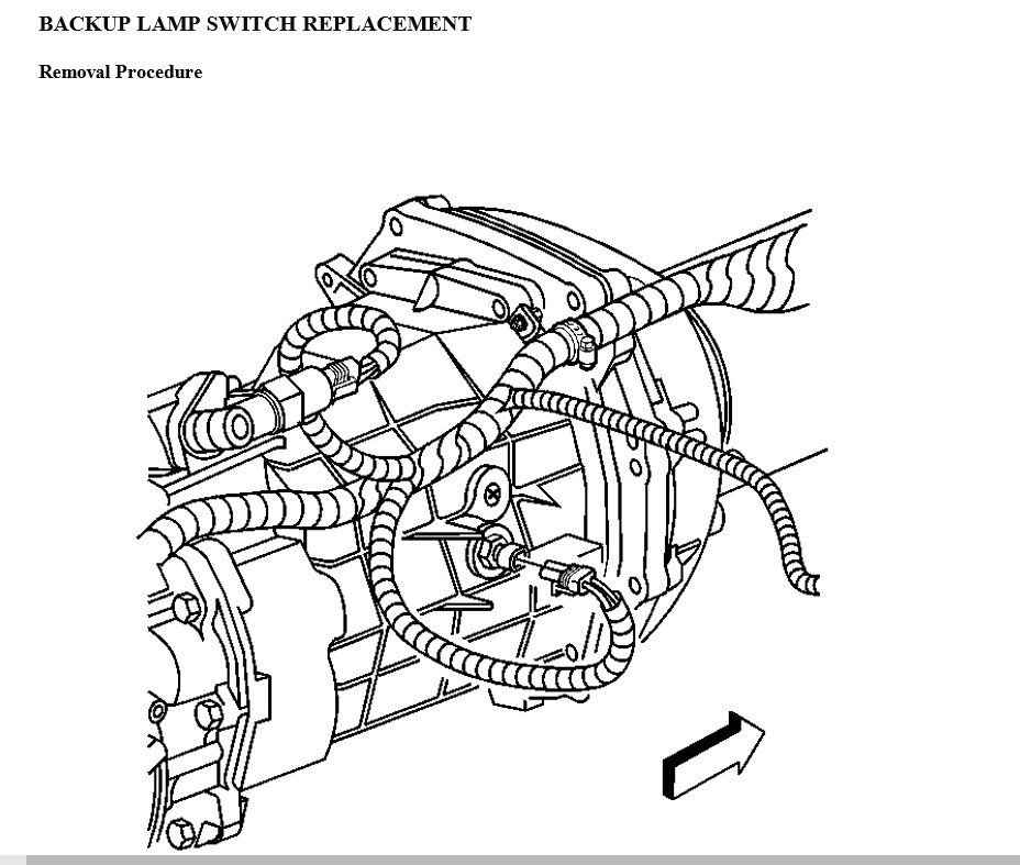

On the passenger side of the transmission (just in front of the rear differential), there are only 2 wired connections. One is at the bottom, it is the trans temp sensor. The other (Back up Lamp switch) is above it, near the top but still on the side. Simply unplug the connector, use a 7/8" deepwell socket and unscrew the switch. No fluid will come out. The switch has a ball plunger on the inside that opens and closes the circuit. Screw the new switch in and firmly snug it down. Don't over tighten. Keep your socket straight while tightening so you don't crack the plastic connector. Plug the connector back in.

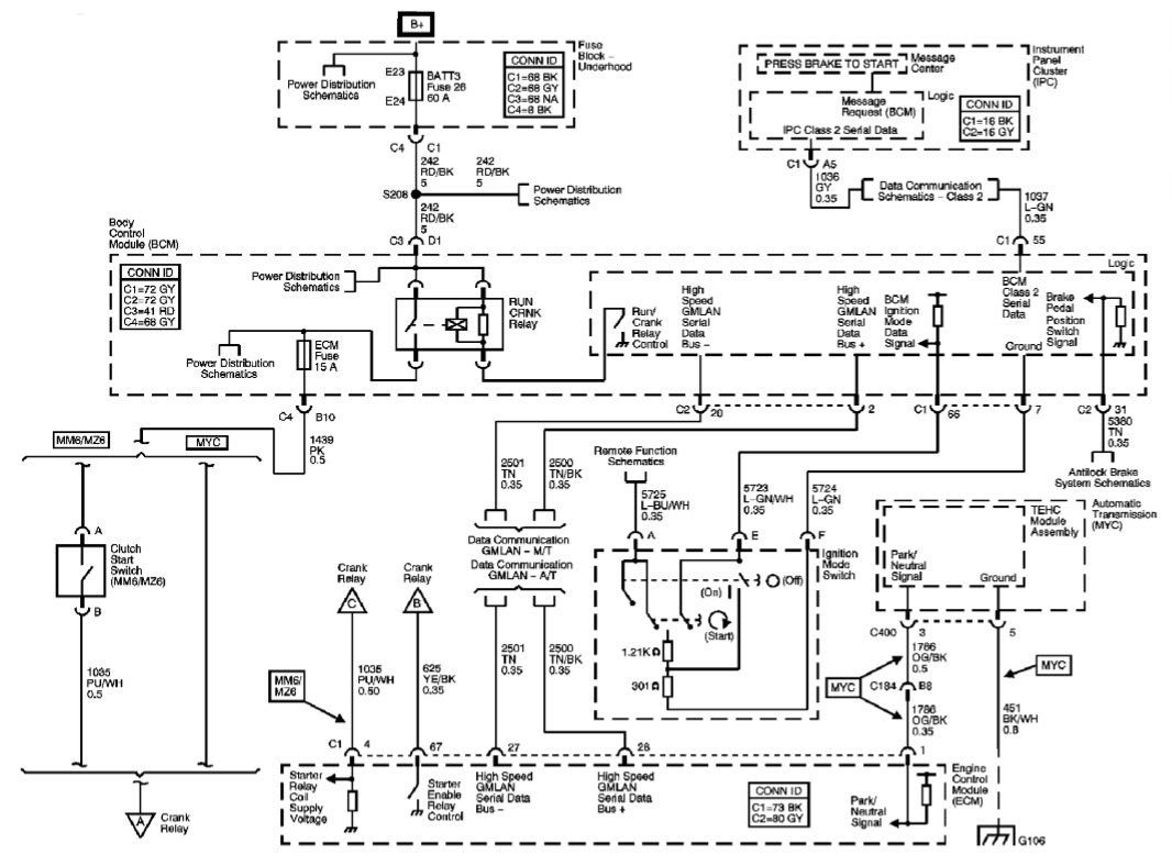

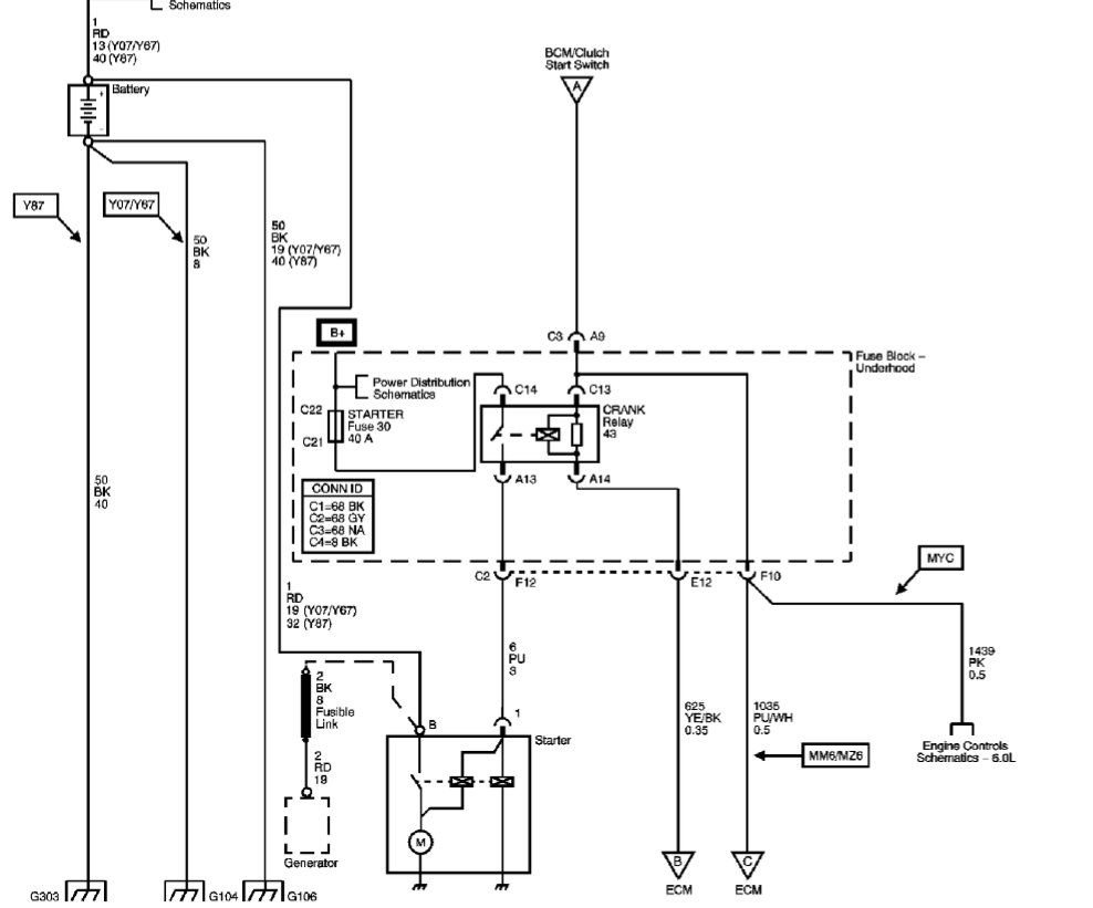

It could be a few things that is preventing a start.
Starter solenoid bakelite broken, thus not making connection. Have you checked all the wiring and ground wiring from battery to starter.
Have you checked the main 60Amp fuse, and the other fuses that are part of the charging/starting circuit.
The Clutch Start switch, etc. etc.
Here is the schematics
Starting Circuit Description
When the ignition mode switch is placed in the START position, a discrete input is sent to the body control module (BCM) notifying it that engine start has been requested.
The BCM then verifies that the brake pedal has been depressed with a discrete input from the brake pedal position sensor and that the key fob, with the correct code, is in the vehicle.
After this information has been verified the BCM grounds the control side of the RUN/CRANK relay closing the switch side of it and allowing battery positive voltage to flow from the BATT 3 fuse through the RUN/CRANK relay switch, engine control module (ECM) fuse to the battery positive voltage side of the CRANK relay coil.
The BCM also sends a high speed GMLAN message to the ECM requesting engine start.
The ECM will then verify that the internal mode switch (IMS) is in Park / Neutral or the clutch pedal is fully depressed.
After this has been verified the ECM the supplies ground to the control circuit of the CRANK relay closing the CRANK relay switch circuit and allowing battery positive voltage to flow through the STARTER fuse, the CRANK relay switch to the S-terminal of the Starter solenoid cranking the engine.
Ground is supplied through the engine block.
Good luck
