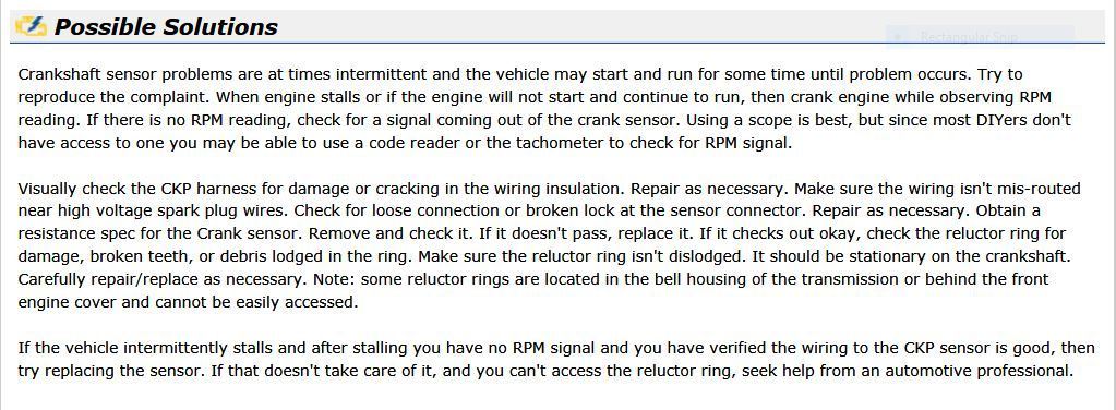

I got a Code p0336 can you guys help me I know it's for the crank but why did I get this code? On my head and cam swap I'm sure I didn't touch this. Car turns on and back fires a ton a lot of crackling and the rpms stay at 0 even though the car is on and I can guess around 1500rpm doesn't hold idle I have no leaks to thanks 08 z06

Old Apr 15, 2017 | 07:35 PM
rkj427's Avatar
rkj427
Pro Mechanic
Joined: Apr 2014
Posts: 15,066
Likes: 4,756
and here is one to shoot you as requested..................
good luck with the repair......................

Originally Posted by rkj427
So the car was towed home my dad started the car and it fired right up no problem. Strange what do you guys think this can be.... dan has been helping me out a ton thanks to you brother
Old Apr 16, 2017 | 10:13 AM
Knowklew's Avatar
Knowklew
Joined: Apr 2013
Posts: 251
From: IL
St. Jude Donor '13-'14
Its the Crank position sensor or cam position sensor being intermittent. Replace.
