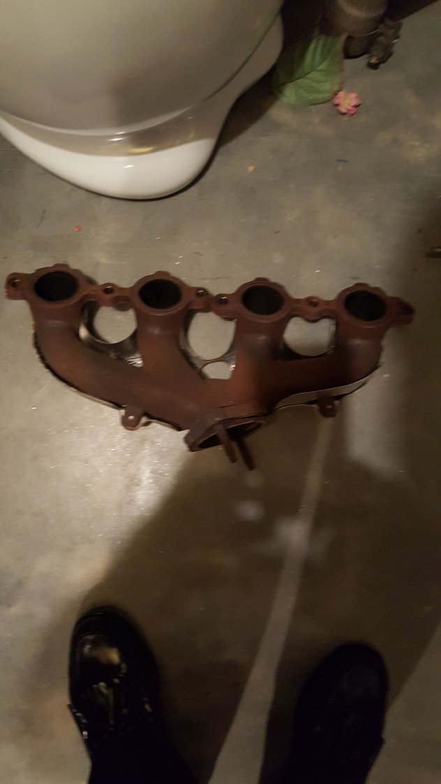

Old May 3, 2017 | 08:47 PM
CMY SIX's Avatar
CMY SIX
Joined: Feb 2007
Posts: 4,684
Likes: 107
From: Opelika Alabama
Originally Posted by Jason Zajac
Trust me it is more than 10 HP. The LS2 & LS3 definitely don't have "factory shorty headers" they are just std cast steel exhaust manifolds.
I beg to differ, have you seen one from the underside?
Old May 3, 2017 | 09:25 PM
Dcasole's Avatar
Dcasole
Joined: Oct 2014
Posts: 8,673
Likes: 2,728
From: Atlanta GA
yep , does not look like a shorty to me
I mean I haven't gotten intimate with one but I have thrown hundreds in the scrap metal pile and tuned enough cars over the past 20+ years to know headers make horsepower & torque through the entire RPM range not just peak #s
The LS3 do not have shorty headers. The LS3 exhaust manifold have 2 "Y" pipes that join prior to the collector. The LS7/9 exhaust manifolds and shorty headers have four individual pipes that join at the collector. Look down into the collector of the LS3 and you will see an open hole. Look down into the collector of a shorty header or LS7/9 exhaust manifold and you will see 4 individual pipes at the collector.
