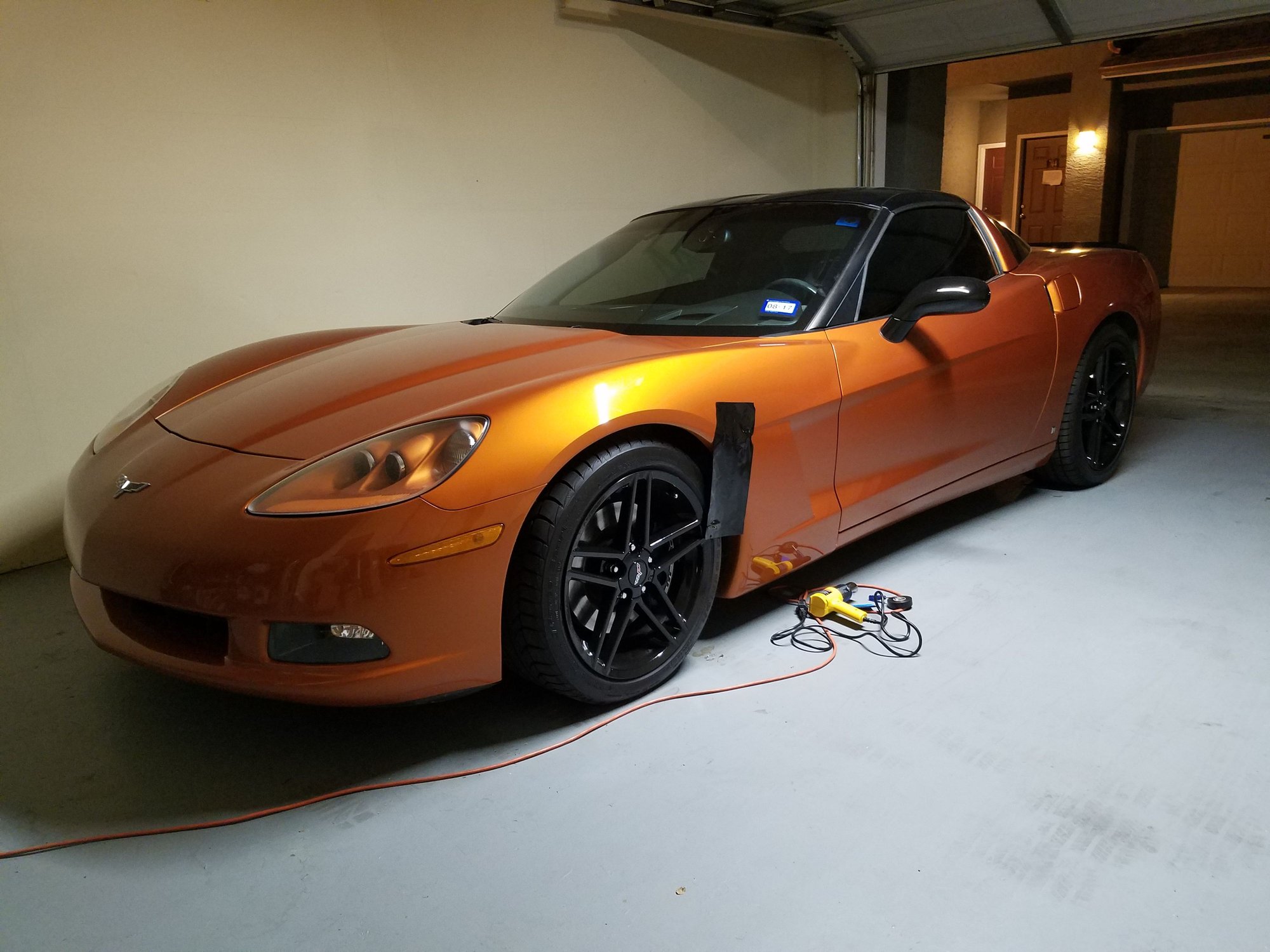

Taking your advice and started the mirrors tonight. They turned out decent for being probably the hardest part to wrap. Halo is next , followed by side splitters and a front splitter.

That's ridiculous. If you were local I would help you do it for the price of a 6 pack. I've been considering starting my own little wrapping side-gig so I take all the experience I can get
The mirrors are done in two pieces though. You can see in person how much curve they have, and I went through a ton of vinyl trying with 1 piece and it just would not lay on the bottom without bunching. They are far from perfect, but I figured it was a great learning experience and they turned out pretty decent

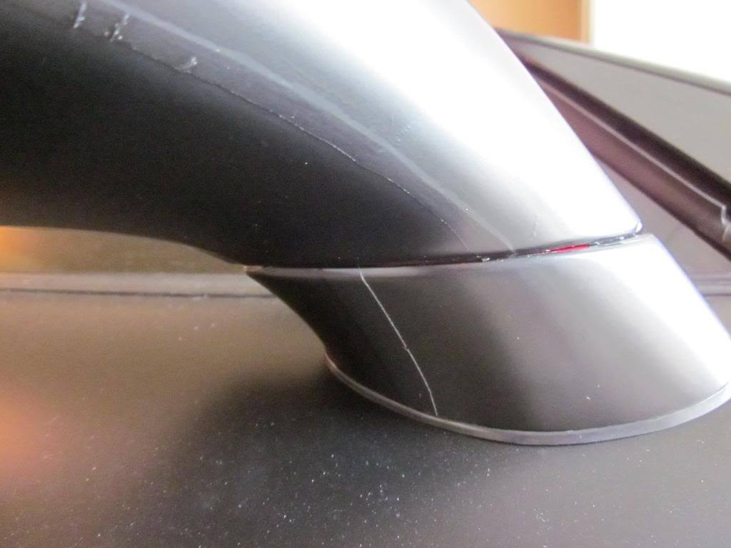

Very similar to this picture I found on another thread here: There are lines, but they face down enough you don't really see them unless you get up close. And you will have to use two pieces. There's no other way. I also popped out the mirrors themselves as it made tucking it a lot easier.
Also, I didn't remove the mirrors. Depending how good you are with your fingers, I was able to wrap the bottom piece (that attaches to the door panel) with 1 piece, and cut along the rubber with a sharp blade and was able to tuck it in by pushing it down with the dull end of the blade. Saved me a ton of time cause I didn't want to remove the door panels and risk breaking tabs and having rattles.
So it ends up like this:
