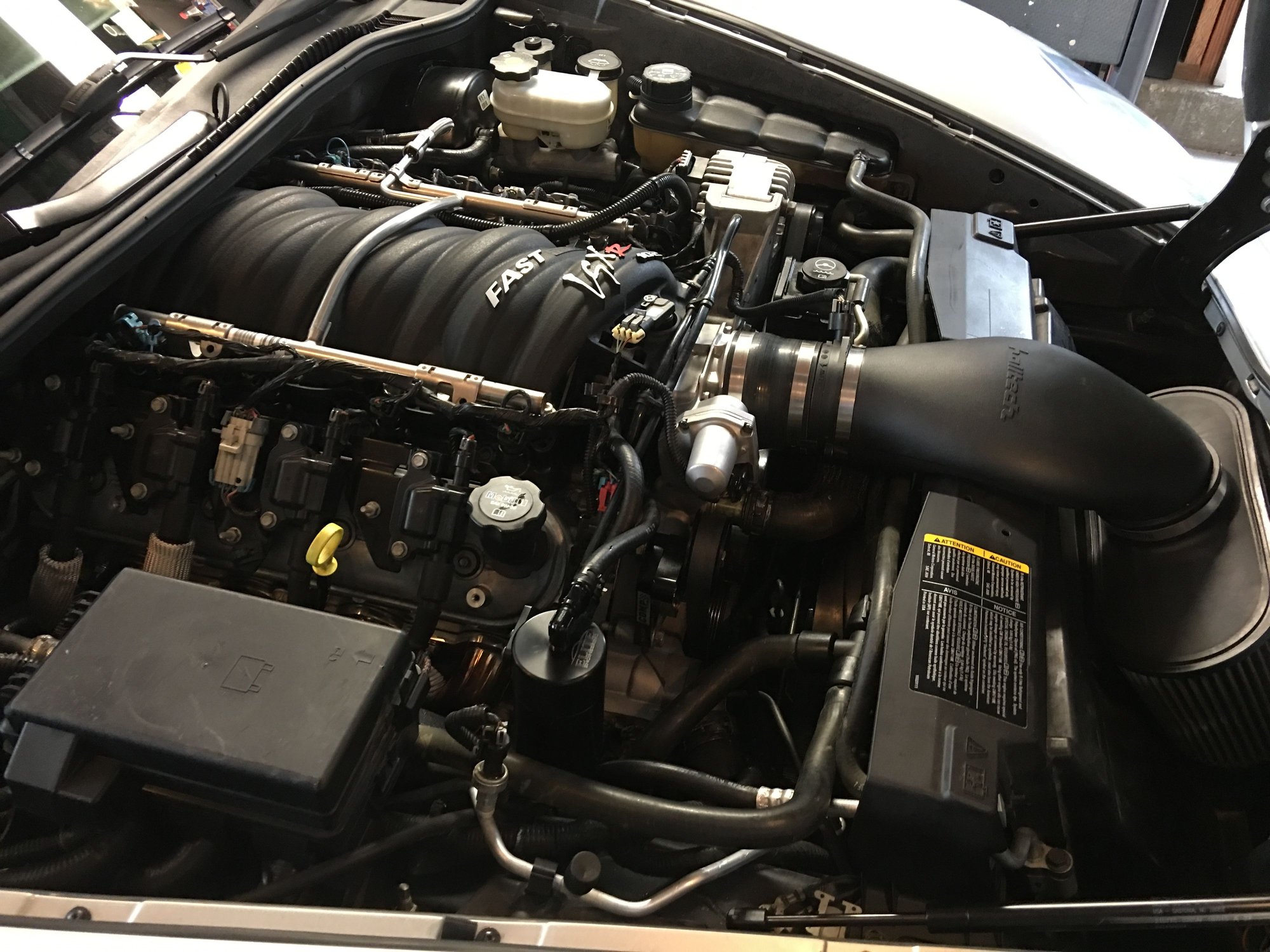

Ive got the Halltech mf103 with the beehive, this cai will install on your C6 with no tune needed per the manufacturer, I installed the kit & the car ran & idled fine just like they said it would, look at their website for hp gains

You read it wrong, your stating your fact? It was not just a "simple" filter change this was my rebuttal. I introduced an outside source of fresh air to this system thus why I posted. I understand I was not clear on my modification to my intake but did not feel I had to. As for performance gains not sure as I added a bunch of mods along with the intake. Below is a link of the version 2 of this intake.
https://www.halltechsystems.com/mobi...ductCode=V2026
