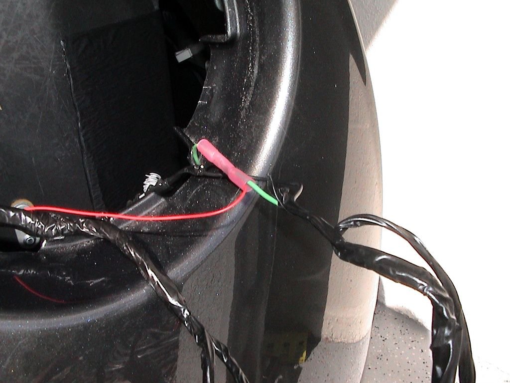

Here's a pic of a tapped backup light wire used to power a camera.
Rear fog lights are for the Euro variation of tail/turn/brake lights.
