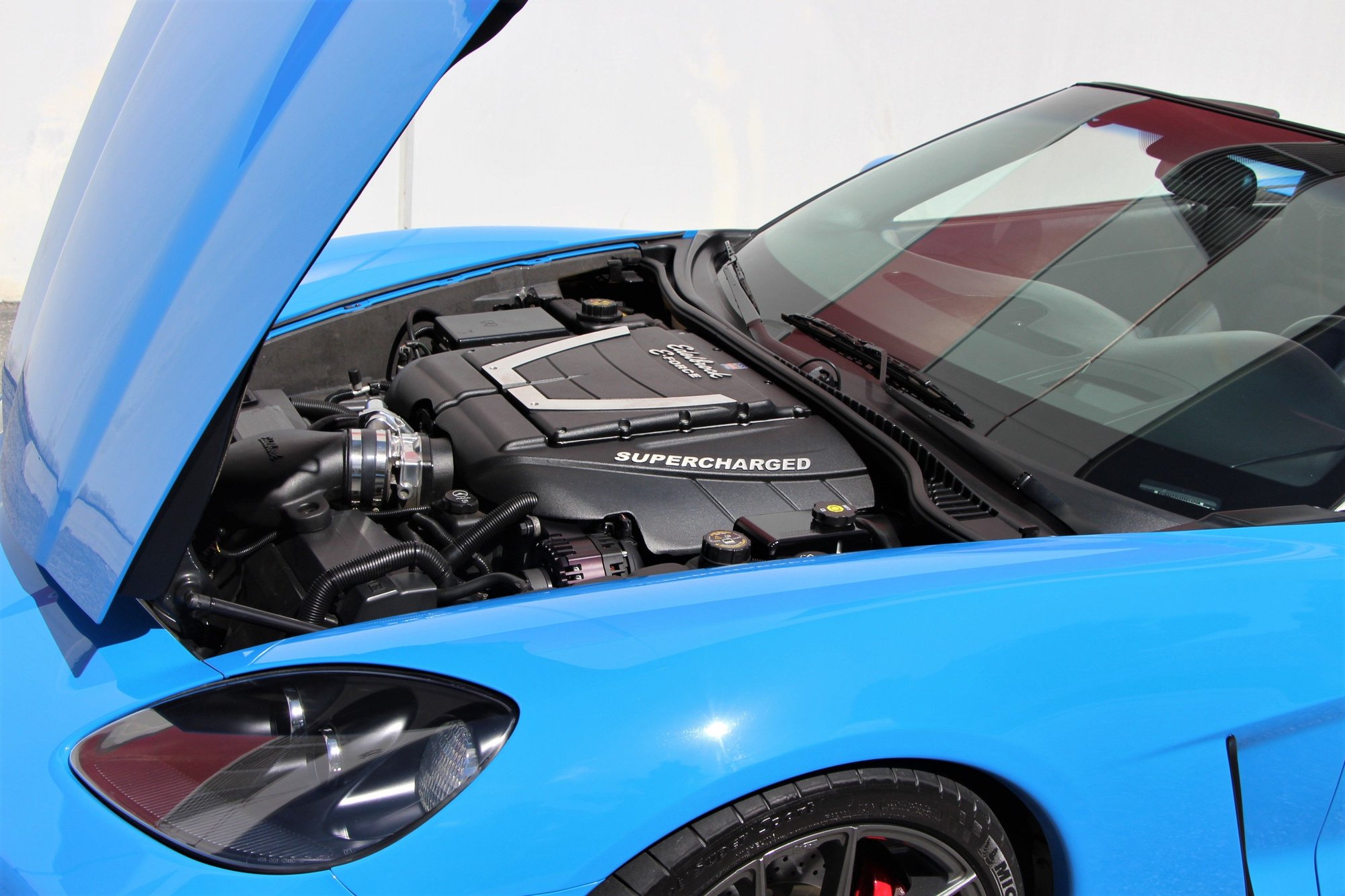

To add, by cooling, combined with the hood clearances, if you look for improved air flow to assist with such issues as heat soak, (which a lot of SCed owners do), the E-Force is different in its proximity to the hood than the centrifugal units and its options with hood ventilation.
Secondly, since it produces the least added HP at the most expensive cost, as a matter of physics, it will be one of the better options in terms of ECTs.
An additional issue is versatility. The E-force will be different in options to vary hp compared to a centrifugal option.
In the end, you might choose the E-Force option, but All worth exploring before spending the money.
