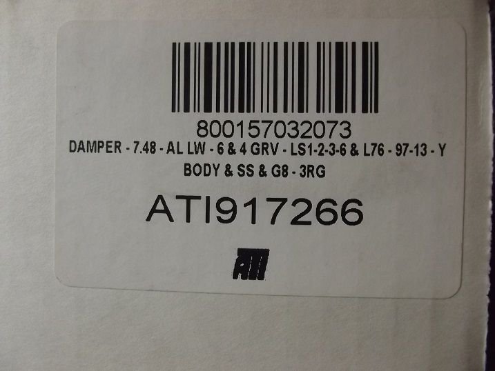

I have an '07 and my balancer developed a bad wobble. The guy that replaced it for me saved the box and the old balancer for me. This is the ATI tag off the box. It works fine, is the standard size, runs true, makes no noise... I'm pleased.
He used a new GM bolt, a new GM seal and I picked up a set of Gates belts on the way to his shop.
This is really helpful and very much appreciated.
Thank you!
