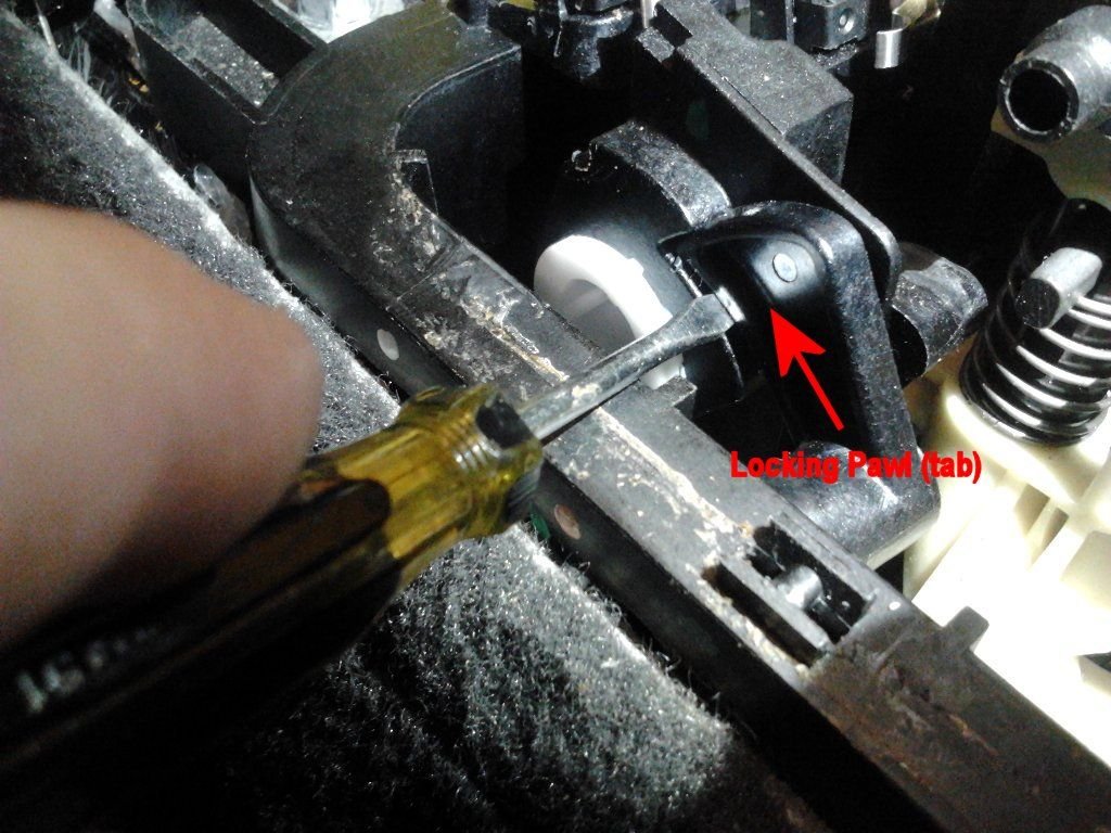

If the shifter is hard to get out of Park after starting,caused by the microswitch not making contact enough to fully release the locking pawl, then the locking pawl will not allow the shifter to get back into Park position.
You need to remove the console, and release the locking pawl using a small screwdriver, as per the attached pic.
Your right micro-switch (pic) is starting to fail, or not making enough contact, so your issue will get to the point where you can't shift out of Park after starting the car. Either replace the micro-switch or tie back the Locking Pawl and no more worries about either scenario.
Good luck
