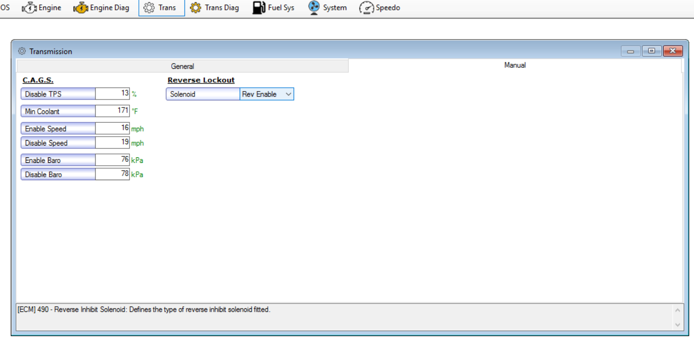

Rethinking this, if the fuse blows or the resistor at the trans fails, either of those two would cause an open circuit and, not only would the skip shift fail to engage, but a failure notice would probably be deployed in the form of a CEL or DIC message.
I can only think of two reasons for an intermittent operation:
First - You're observing the normal operation of the skip shift and NOT an intermittent failure of a bypass. The skip shift needs a number of parameters met to activate. It is not an "every time" circuit.
Second - A resistor fuse is installed with the wrong value which is so close to the minimum voltage needed to activate the trans solenoid that sometimes it engages and other times it almost engages.
Here is a screen capture of the parameters that govern CAGS in the tune. All of the thresholds need to be hit before CAGS engages. I'm beginning to think you are observing a normally operating CAGS with NO bypass intervention.
SIDE NOTE: To eliminate CAGS via tune, you only need to modify one parameter to a value that is unattainable. Tuners usually pick ECT and set it to its maximum in the tune field which is something like 340*F. Since that temp is never reached, CAGS never engages. ECT is what I did when I tuned mine out.
