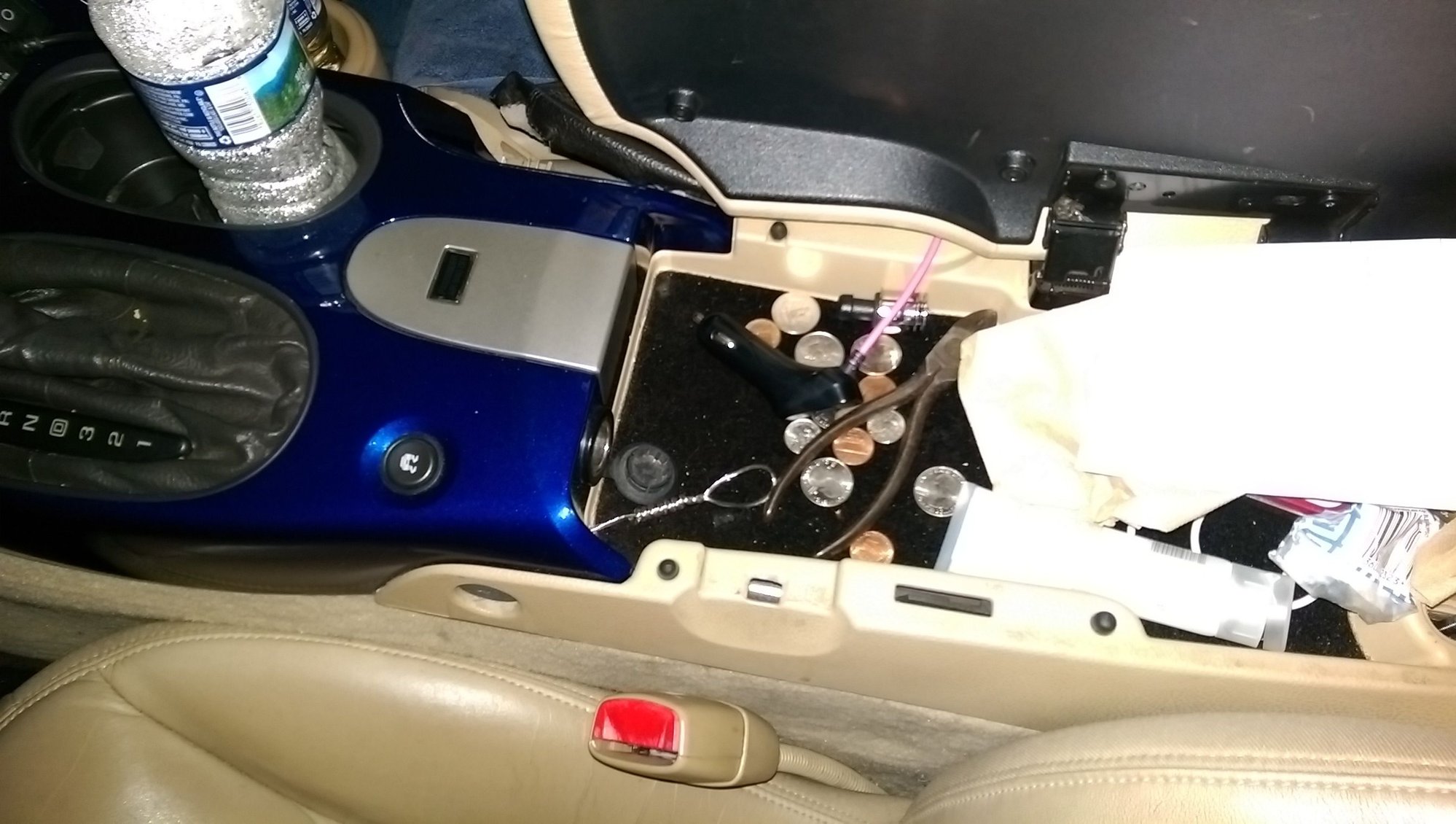

It's supposedly caused by a bad limit switch, that will not energize the solenoid that releases the shifter locking pawl.
You can replace the limit switch, or tie back the locking pawl to eliminate the issue entirely.
Here is a PDF on tieing back the solenioid.

This is a pic of the wire pulled into the center console. The hole is drilled through the cashmere portion. I used plastic-coated picture-hanging wire.
This is the best way to tie back the pawl, IMO.
I agree with that as the best solution.
