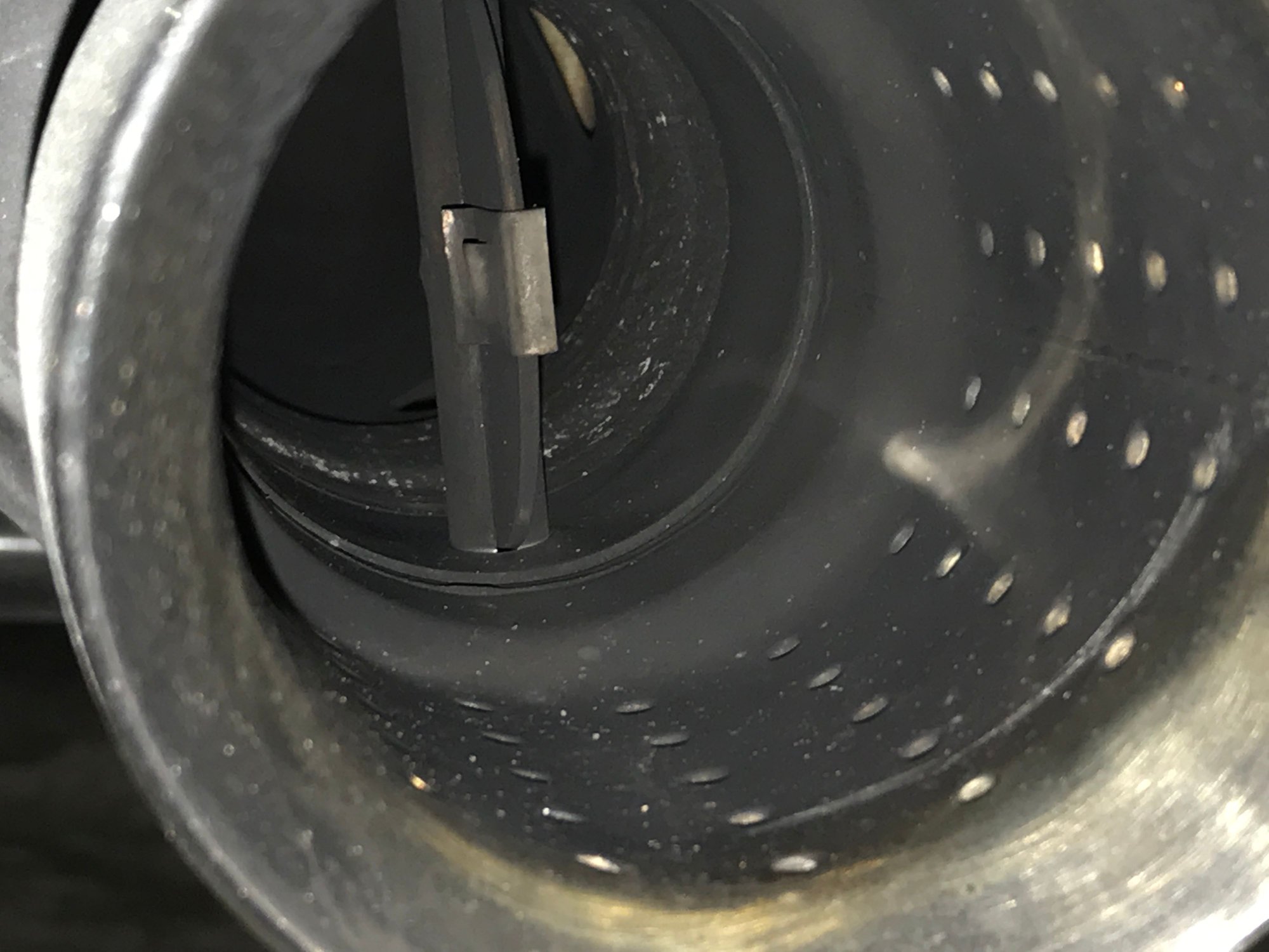

The highway drone is real and drove me and my wife crazy. And at low speeds, it pops like mad on decel. If that's not acceptable you can add the M2W, or as I did add some spacers to the vacuum butterfly shafts to keep the straight pipes slightly open full time. I added (or subtracted) spacers until I was satisfied with the sound at idle, at low around town speeds and 70+ on the highway. Sounds really great. Pipes open up fully as designed at 3,500 rpm.

Originally Posted by jost6453
'Open' gets kinda annoying on the highway. 'Mild' is way too tame. I installed a dead pedal foot switch to control the NPP, but opted to place clips (like speed nuts) on the butterflies to prevent them from closing completely. They are still adjustable but easier than the collar method. And the huummmm in 'mild' is absolutely perfect. So around town I switch between the two positions, but leave it in 'mild' when on the freeway. No drone with the modified 'mild'.
Here's a pic of the cllip (speed nut) that I mentioned before. Just slide it over the butterflies to hold them open slightly. You can adjust to your own taste. Mild is more lively and NO drone on the highway.
