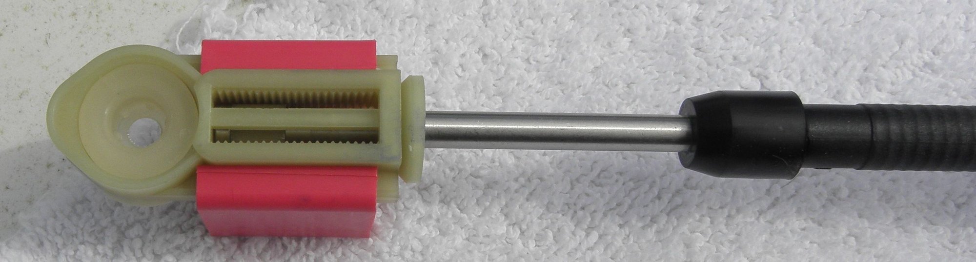

I believe that you can lenghten or shorten the cable at the transmission end to get the gears in the correct configuration. It sounds like you have to lenghten the cable at the cable lenght adjuster a bit to get it right.
Here is a pic of the adjuster.

Jeeze - Oh. After seeing those pics it's easy to see why there is a problem with the cables. They look about as stout as a 50-cent ladder. Thanks GM.

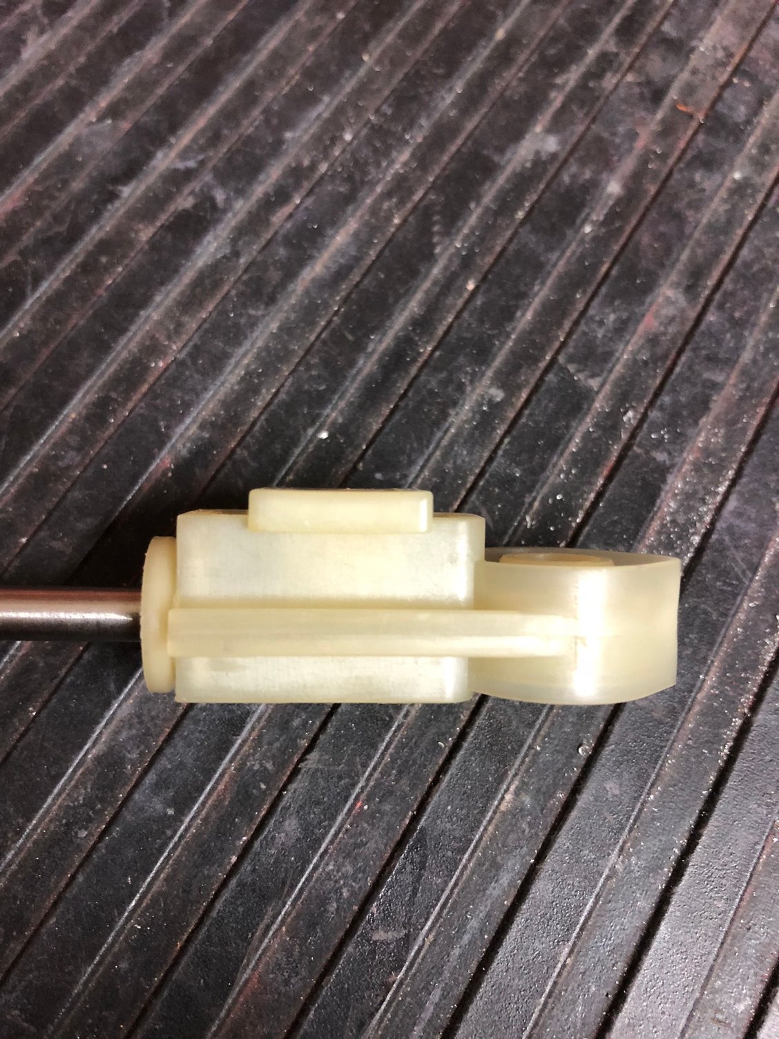

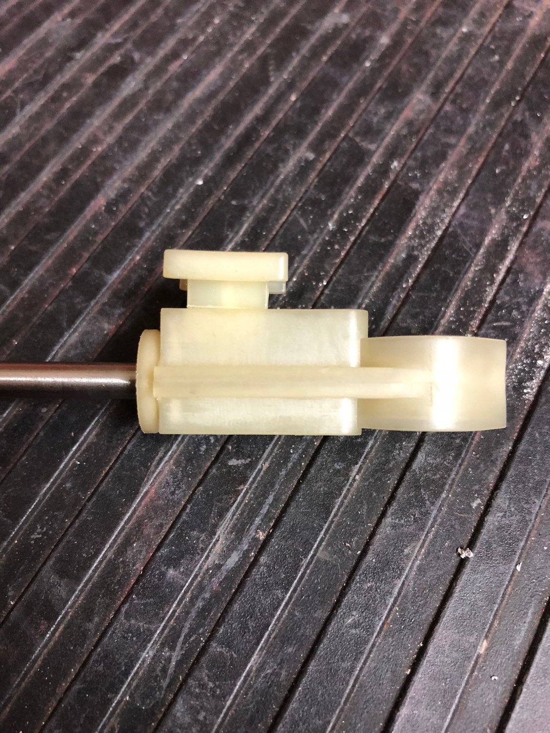

I guess my first question would be, when you installed the cable, did you remove the red cover on the transmission end of the cable?
With the red cover off, you can see how the adjuster operates. With the adjustment correct, the tab on the adjuster is pushed in to seat it into the adjuster and keep the cable from moving within the adjuster.
To obtain the correct adjustment, raise the back of the car and support it on stands for safety. Remove the cable end from the transmission. From inside the car place the shifter in the neutral position. From under the car, rotate the lever on the transmission clockwise until it can't be rotated any farther. Rotate it back the opposite direction 2 clicks (or detents). This should put the transmission into the neutral position. Snap the cable back onto the lever, and then push the tab on the adjuster all the way in to seat it.

Yes, I removed the adjuster but not sure if the tab was in or out when I removed it. So, i’m not sure where the clip was originally but will follow the instructions given.

The tab is "out" when the red cover is still on the cable, or even when removed from the cable. It must be pushed in to seat it after installation, and adjustment. Good luck.

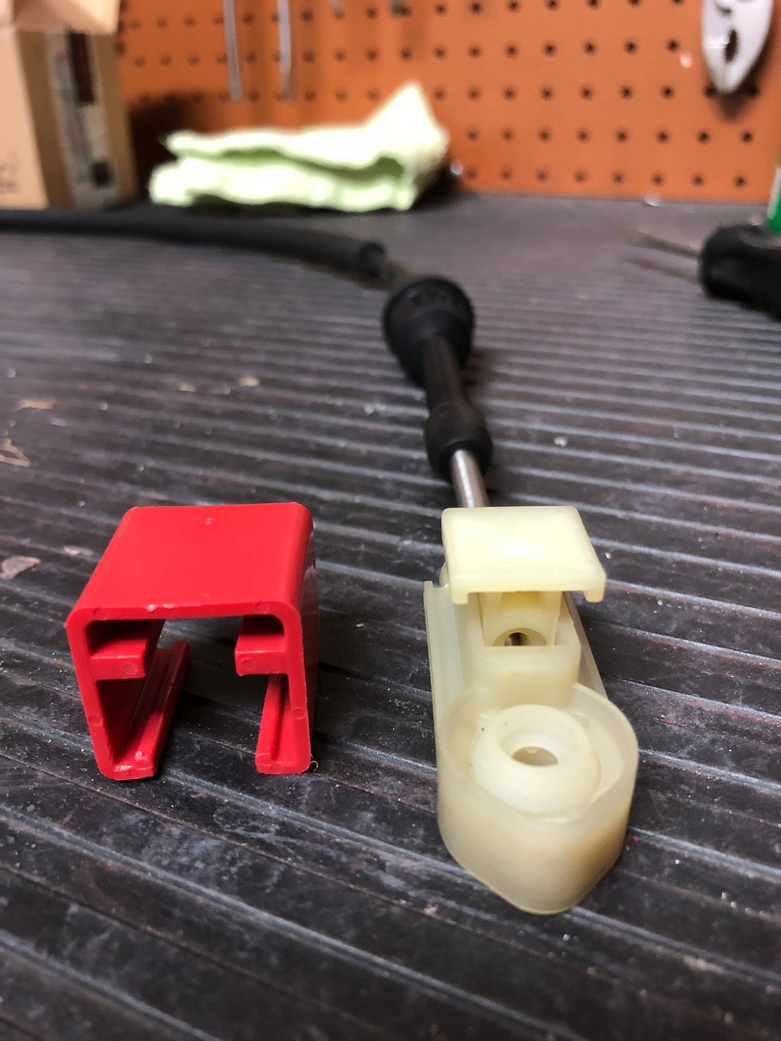

Does the adjustment tap/red cap face towards the transmission or away? Right now I have it facing the trans

You are supposed to take it off after installation

Correct I plan to remove but the connector spins 360 degrees and not sure if it needs to spin 180 degrees and connect on the other side with the adjustment tap/red cover faces away from trans.

If I remember correctly I believe the open end of the clip faces the transmission. As previously mentioned take it off the transmission shifter in car in N, lever on transmission 3 clicks from the rear is N Snap back on.
