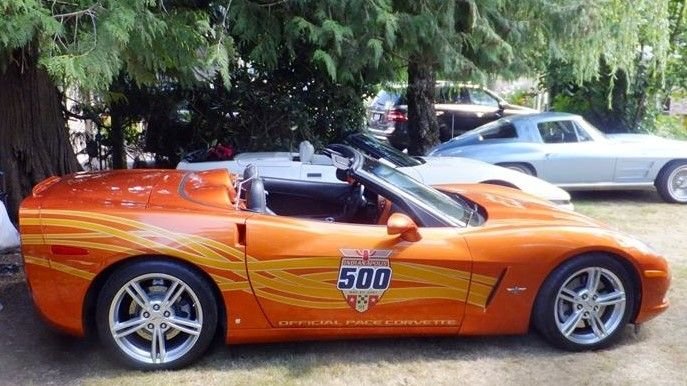

Congratulations on your Atomic Orange 2007 Convertible. We basically have the same car only ours is a Pace Car Replica. I also love this car. I had a similar situation with the seats since the previous owner used an entirely wrong product on the seat leather making the seats shiny, slippery and appearing more like cheap vinyl seat covers than the matte leather finish they were supposed to have.
The product that worked for me and restored the seat was a leather care kit from Auto Glym. I cleaned the seats with Auto Glym Leather Cleaner Spray and a medium bristle scrubbing brush followed by a rinse with a damp sponge. Once the leather was dry I applied Auto Glym Leather Balm with a damp sponge letting it dry then buffing it with a micro fiber towel which left the proper matte finish and an amazing new car leather smell. I did have a problem you don't have insofar as I have the Indy 500 Logo embroidered into my seat tops so had to be extra careful in that area so as not to stain or discolor it.
Since the previous owner suffered for a couple of years with a terminal illness the car needed a lot of remedial detailing. It took me 3 weeks of every minute I could spare to get it done but near the end of summer I took home a car show trophy for best C6 Convertible.

Thank you for the great lead on the Auto Glym product. It is Black Friday and maybe I can find it locally discounted and give it a try.
Your pace car is beautiful! I really like this Atomic Orange color as it stands out from everyone else's car. I have a couple comments and questions:
1. If I am unsuccessful in "rejuvenating" my driver side headrest, I will be happy. If not, I am considering buying black leather headrest covers from Interior Innovations.They claim to look factory (their opinion). In addition, I modified their website picture and added 2 Corvettte insignia patches to get an idea what that might look like. They do not offer an embroidered insignia, which I would like to have. I would likely need to apply them with some type of 2-sided tape, which I'm not too keen on. I'll post my photo shopped type picture (blue exterior/ white interior on website picture).
2. Not sure if your car is a Z06 (mine is not), but I am kicking the idea around about painting my calipers possibly yellow or Atomic Orange. I enlarged your corvette picture and could not tell if yours are painted (which I think was an option on the Z06?).
3. While "scoping" out the enlarged picture of your Corvette - do I detect a windscreen? If so, that is another option I am considering. The picture clarity in the enlarged state was a little blurry so it might be something else behind the seats. If you do have one, please tell me if you think it is a worthwhile thing. I've been looking at one that is clear with an option that lights up the edges and a corvette symbol in the middle of it, when you apply your brakes. It might seem a little flashy but I am thinking about it.
4. I noticed your trim around your radio is Atomic Orange - very cool! I am guessing your engine fuel rail cover is also Atomic Orange. Do you have the 7.0L engine (I have the LS2 6.0L).
5. Anyway, I am considering a dash kit in Atomic Orange. See pic.
I could go on, but I think this enough for this reply! Thanks.

You are correct having noticed the Wind Restrictor (brand) that I installed. Yes, it is worthwhile and is about a 50% improvement over having none. The illumination kit really makes it show at night and I also installed the dimmer kit so I can tone it down a bit as this picture shows it at maximum brightness. You have a choice of clear or smoked with the plastic as well as the standard C6 logo or custom logo. I chose the custom Indy Speedway logo but some fancy custom graphics work is also available and you can even submit your own designs. Incidentally the squiggles you see in the picture are my attempt at masking the glowing blue lines and dots caused by a defect in my camera that shows up in night pictures.
The Pace Cars only have a few changes from a base 3LT. They all come with the Z51 performance package. The front and rear brakes are about 1" larger and have drilled rotors, the front and rear sway bars are larger diameter, the shocks are firmer, there are coolers for power steering and engine oil and lastly they have the split spoke wheels finished in "Sterling Silver" and mounted with Goodyear super car tires which are still crap so they were replaced with Michelin Pilot SS ZP.
The car is currently in winter storage but this coming March I will be removing the wheels and sending them to a specialty wheel repair company where they will re and re the tires, strip and refinish the wheels, repair the curb rash, replace the TPMS sensors that are at the end of life and re-balance them as a package deal.
At the same time I am considering ordering and installing the color matched painted caliper covers as they look nice and are a lot less work than painting the calipers yourself. I have dealt with Zip Corvette one of the vendors on the forum for a lot of my supplies and accessories.
The engine in my car is the same as the base LS2 but has the fuel rail covers also finished in Atomic Orange. Good luck in your choices and have fun with this fabulous car.
