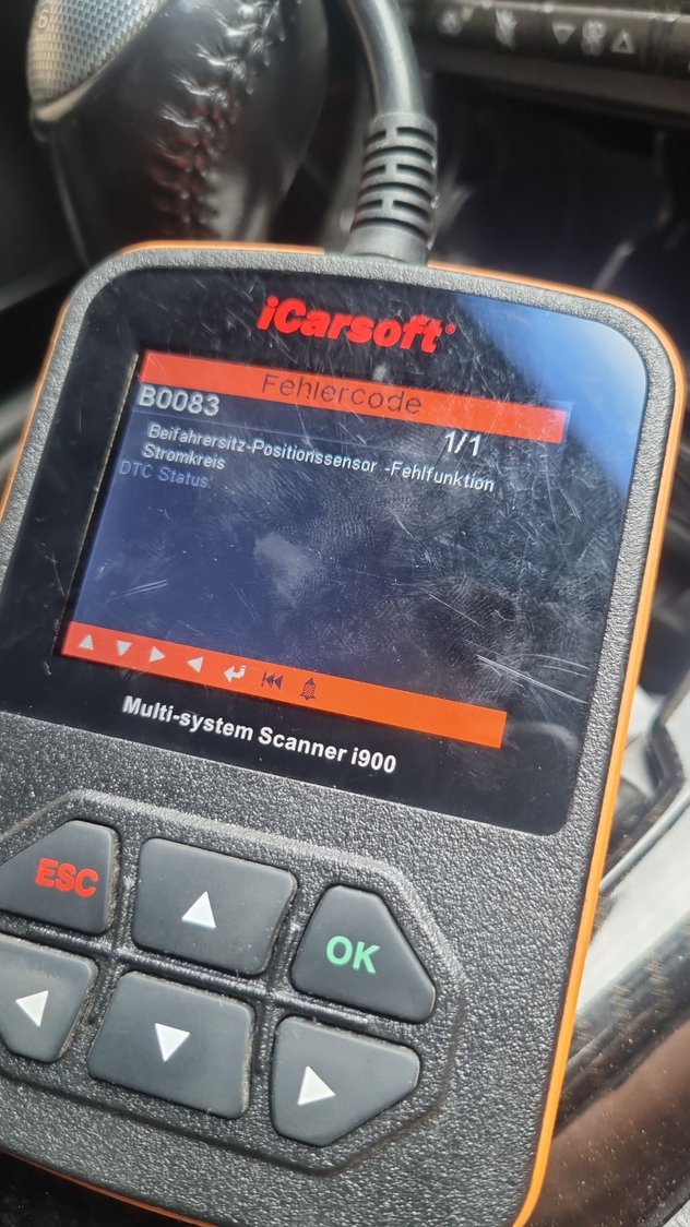

Hello guys I have the same problem can anyone tell me what I need to do??
I have two Recaro pole position seats I order It new airbag kit for the passenger seats from vetteworks but he not answered my questions
B0083 code

I need this part Here 19180158 seat position sensor for the passenger site is that right???
