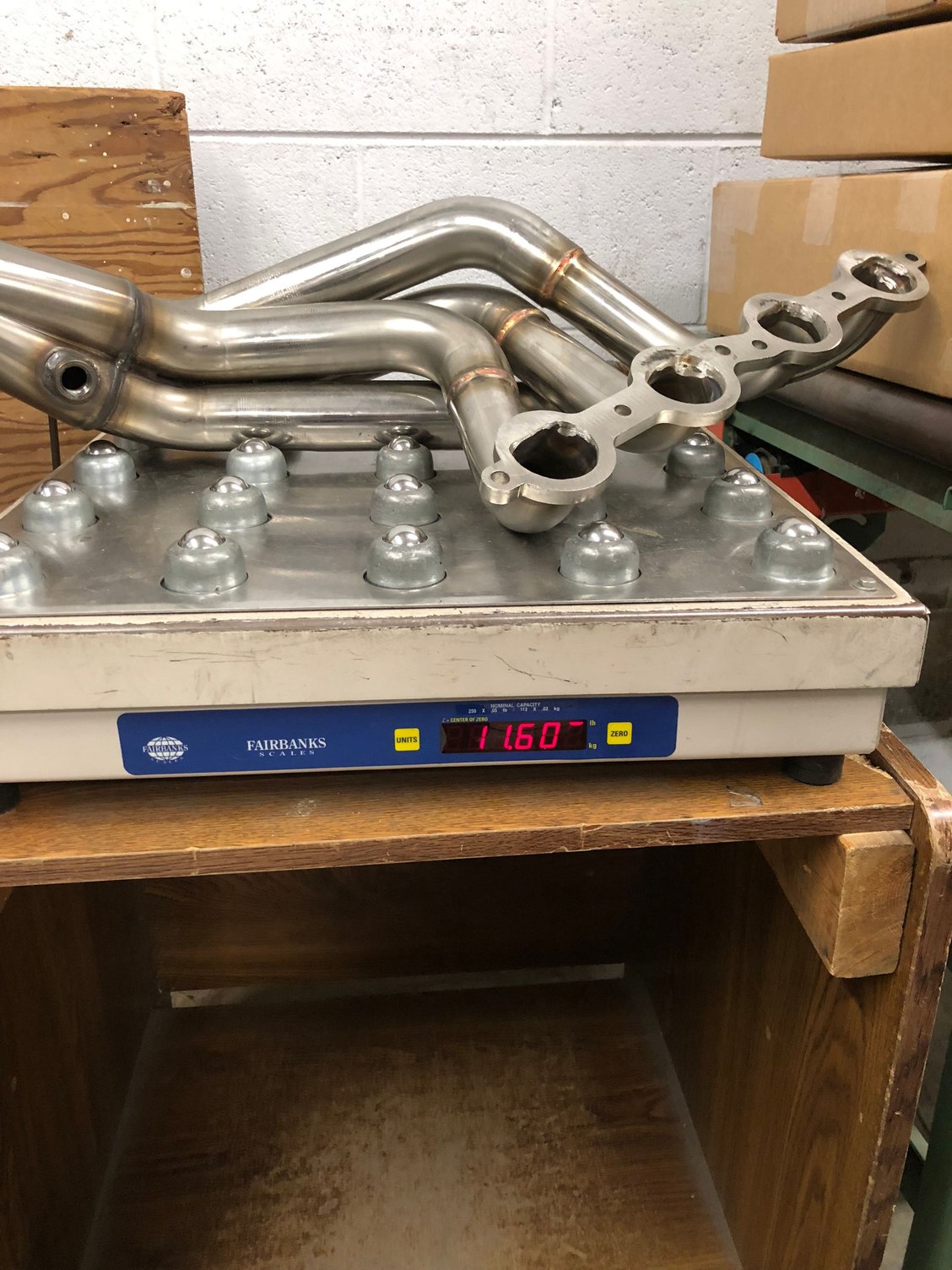

WindyC6, Just for you I went back and weighed them both.
So the difference is 2.6 lbs all together or better yet a difference of a power to weigh ratio of 6.202 to a car with headers of 6.197.
Not much gain there and to be honest with the price of headers for that, just go eat something really greasy and you will lose more wight than that and gain a better power to weigh ratio. So going back to my original statement the logic behind headers is the fact that they create a vacuum in the cylinder. So that when the intake valve opens there is already a vacuum present so that you get 100% fill of fresh air and fuel and will there for make more power in that one stroke then a car with a manifold present and still have wasted fuel air in the cylinder. So with our new setup the avg gain of a set of headers with nothing else is about 25 hp. So with that our new ratio would be 5.904 hp but the great thing about a clean cylinder is now with a new calibration we maybe able to increase timing and gain 35+Hp with the headers which would lead to a new ratio of 5.74. So the benefit of the header scavenging the cylinder far outweighs any gain from weight savings. I know the internet may say other wise, but here is the math and science behind it. Now if you wanted to shave some weight and go with our rotors that would save 40lbs on a ZO6 and your new ratio with those with headers could be 5.66 when compared to 6.202 earlier. For those that are not understanding what these numbers (ratio) are, they are how much how many pounds is being pushed by 1 HP. So when we are all bench racing a new GT40, they have a power to weight of 4.72. This is not the only thing that would decide if a car is faster vs another, but it is the start of how you could determine, but there are other factors as well. Like a Chevy Volt with a LS7 in it will be faster than a New ZO6 in a straight line but not at VIR.

Good job. And I must admit that I would have thought of a slightly bigger diff then that. Knew it wouldn't be as much as back in the day though cause the manufactures are cutting weight anyway they can. And at my age I wish eating some good greasy food would make me lose some weight that easy !!!!.........

Proof given, proof denied.
