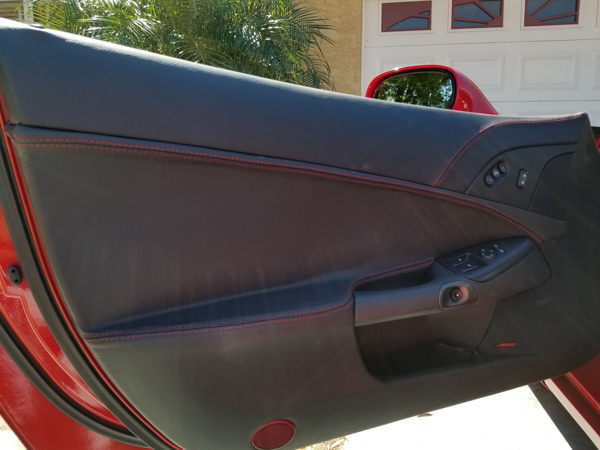

It's not bad I used spray glue in a can. The trick is don' let the glue get too tackey and take your time

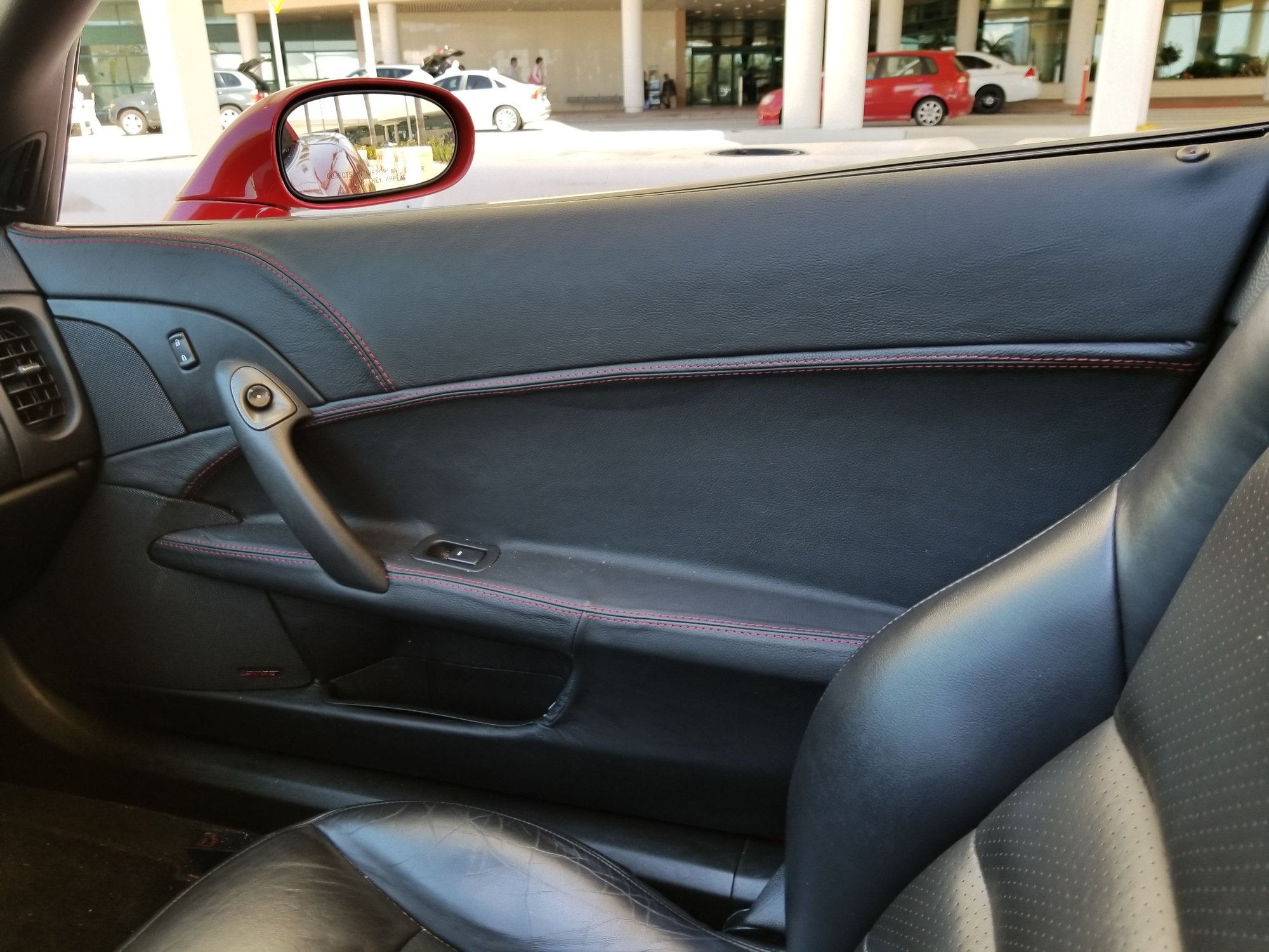

It comes with all the pieces to do the whole door but I only did what u see. It takes a couple hours each door. I did a small section at a time maybe a square foot. I watched a few vidios on you tube to get a few tips

Originally Posted by bacord
That looks great except for the bump just along the bottom of the armrest. What caused that?
I think your seeing the seam whe re the leather is joined. That picture is in the florida sun at about noon with the sun strait up. It really isn't that noticeable in person. On the seam on top of door I trimed the leather so its a lot better. Some say to use a heat gun to streach the leather better but i didn't so I'd use a heat gun and trim all the seams if I did it again. I really looks good in person.
