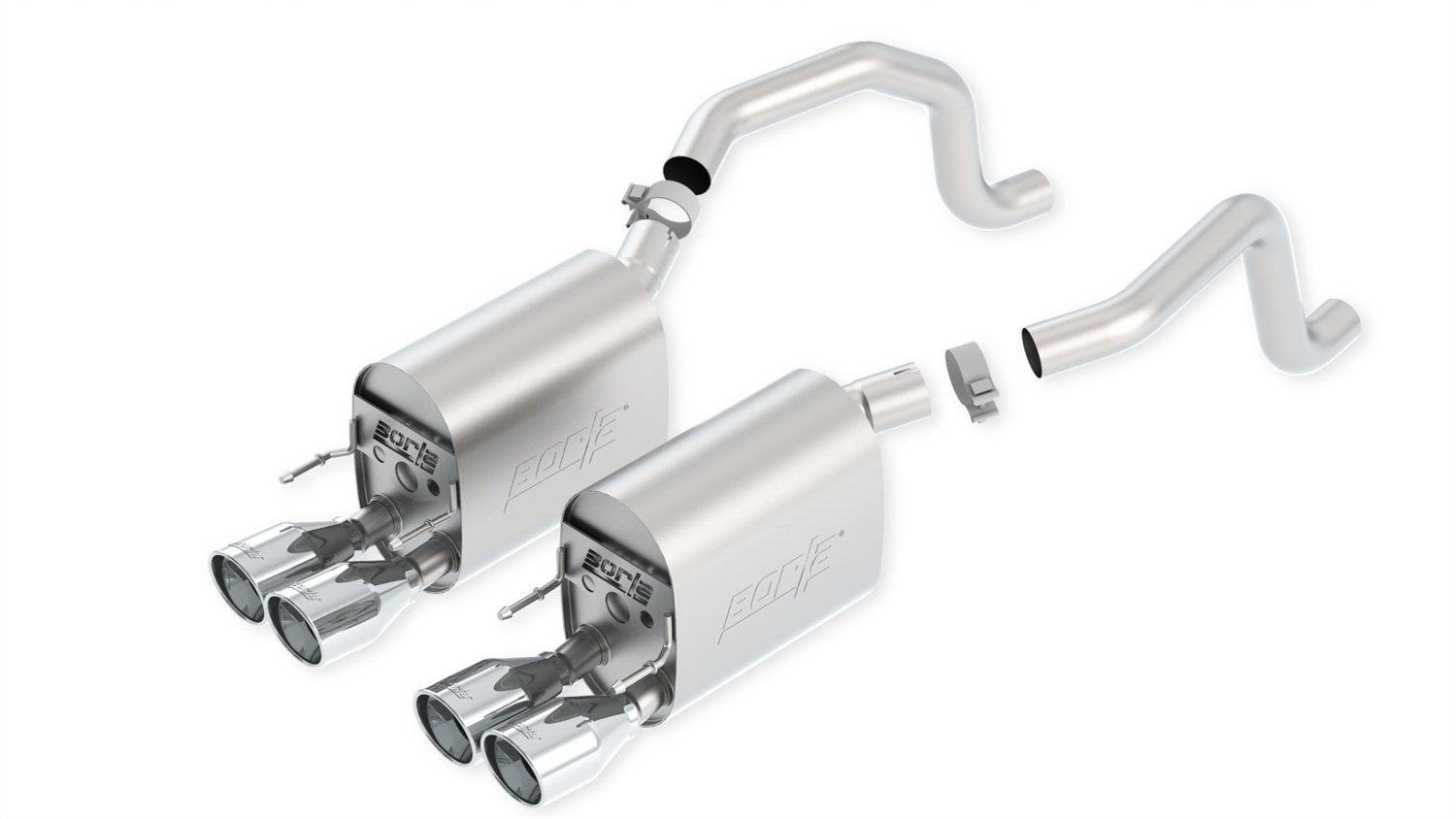

which borla system is this?

Default which borla system is this?
its not atak or stingers
havent been able to find which one this is based on the mufflers
If you see GCA on them, it's the GM upgrades mufflers that where made by Borla.
Exactly ...
Basically an early version (Classic - Type 1) of the Borla "Touring" mufflers.

I'm assuming that a touring muffler would be quieter and not drone comapred to my lg gt4
Ill have to ask the diameter of the over axle pipes and try to snag them

I have the same Borla Touring (Type 1) on my 2011 GS. I purchased this directly from Borla at a big discount when the type 1 was replaced by the newer type 2.
The only difference I can see is that mine has the oval tailpipes.
The only reason I replaced my NPP exhaust with the Borla Touring is that after installing a set of headers, the NPP exhaust became obnoxiously loud at wide open throttle when the NPP valves would fully open.

Just hope the new mufflers fit ...
I don't know the C6 model year the change took place ... but, one of the inlet pipes on these axle-back muffler systems are bent slightly different from the early years C6 vs the later years C6.
__________________________________
EDIT: Ok, I did some checking
2005 - 2008 . . . All the same, and use the same P/N
2009 - 2013 . . . All the same, and use a different P/N from the 2005 - 2008
Also ... The Base and GS have 2 1/2" inlet pipes ... The Z06 has a 3" inlet pipes

The Borla Touring Type 1 was replaced with the Borla Touring Type 2

The Borla Atak is much louder
This is the older style Borla Atak Type 1 ... Note how much smaller muffler cans are used in comparison to the older style Borla Touring Type 1
