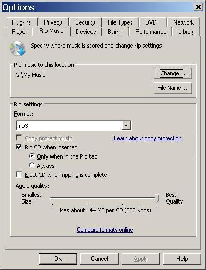

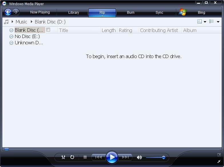

First, I don't know about your NAV system, but I'm pretty sure mine will only play CDs, not DVDs in the 'music' slot. The DVD slot only accepts the NAV DVD, and will not play music. So, assuming that you don't have an aftermarket NAV system, then it's pretty straight forward to rip music CDs using the MS Media Player. I've got an old version of the player (11), but I'm assuming that it hasn't changed that much. I'm also assuming that you are running some version of Windows. Linux is a different, but equivalent story.
First, you need to rip music from your CDs into the Media Player library. Using the 'rip' tab to do that. It's very straight forward:
The Rip tab dialogue
You can tune the MP3 bit rate - the higher the rate, the better the quality, but the fewer will fit onto a CD. However, even using the highest bit rate, I can fit between 90 - 100 songs on a CD. If you have a 6 disk player, then that gets you upwards of 600 songs to play.
How to select bit rate from the option menu

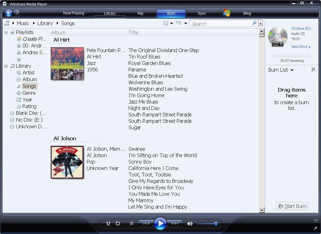

Once you've ripped CDs, you'll be able to see them in your library:
As you can see, I like Jazz.
Now about burning the CD. Unfortunately, it seems that my version of the media player won't burn MP3s; maybe yours does, and if so, there is a burn tab that you start with. On the picture above, it's right beside 'rip'. However, it it doesn't, then you will need some other burning S/W. I use Nero, and the media player saves all of the MP3 in a particular folder on your system. From the screen shot above, you can see that I save everything in G:My Music. The player will create a folder under that top folder for each disk that you burn.
Once you find the ripped mp3 files, then the CD burning s/w should allow you to burn an Audio CD, and you can drag and drop whatever you want into the application. I've created many MP3 CDs like this, and they all play fine. You can drag an entire folder if you like. If you decide to go this route, just burn one CD to start and see how it turns out, rather than waste a bunch to start.

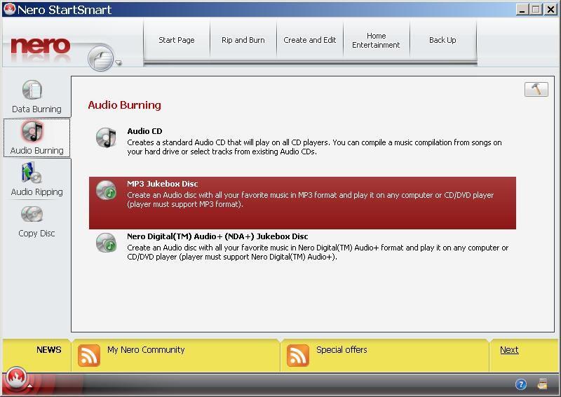

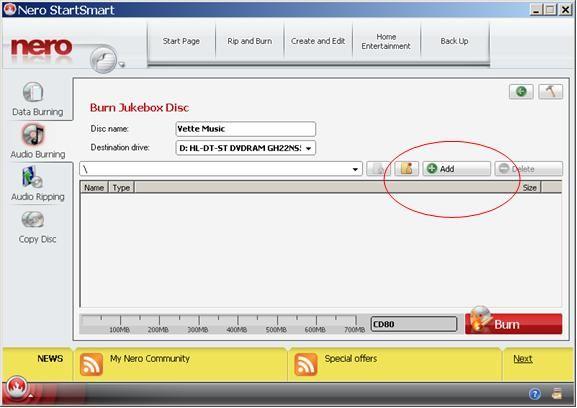

I use Nero SmartStart to get going. I didn't change any of the default settings, except to point it to my CD burner.
It looks like this on my system:
Select the Audio Burning tab on the left
Select Jukebox

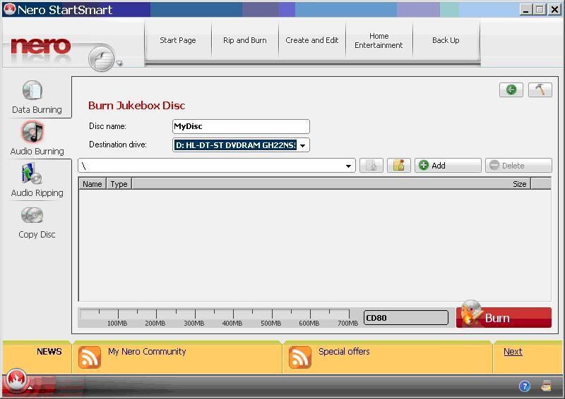

Select the 'Add' tab

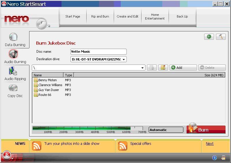

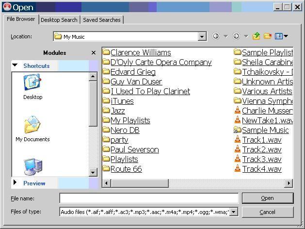

Use the standard Windows file browser to navigate to where your music files are. You can select whole folders, or individual files by selecting the item, and then clicking 'Open'
Here you can see I've added some entire folders. You can use this window to navigate into the folders that you have selected, and remove items, or even add them. You can also create new folders and populate them with MP3 in the same fashion. It keeps track of how much of the CD will be used.

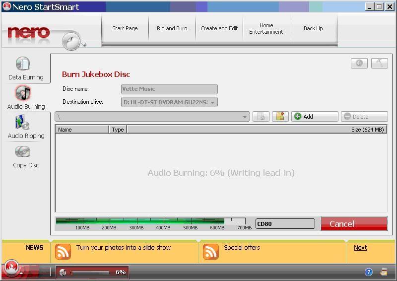

Click on 'Burn', and the CD creation starts.
I just burned the CD that you see in the pics above, and went out and tried it in my NAV system, and it works just fine. Displays titles, musicians, etc. I could have completely filled the CD by working at it, but that's up to you.
Hope this helps.
