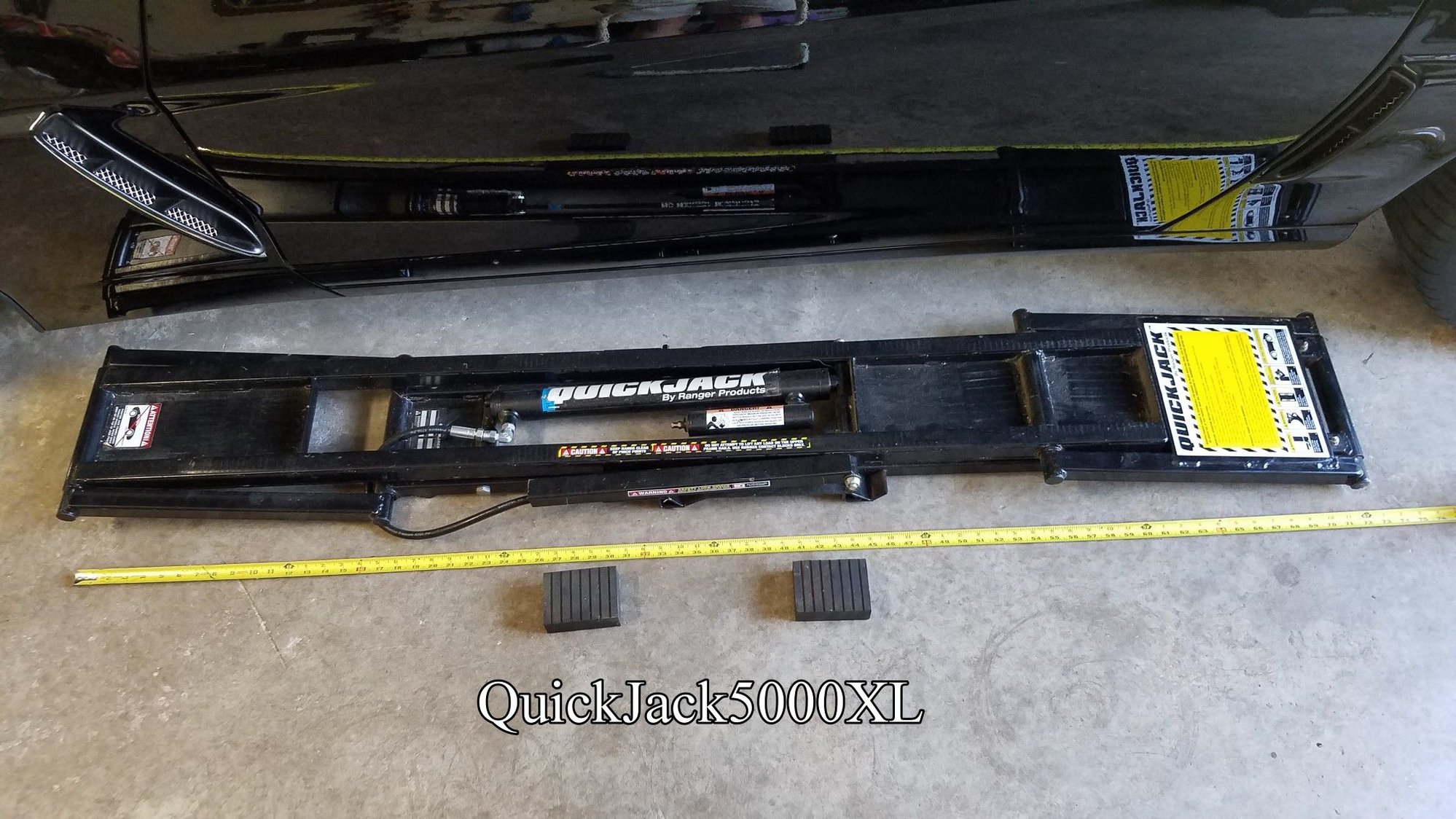

I took some photos in hopes it will be helpful to others. The first photo shows the QuickJack 5000XL next to the Corvette with the rubber blocks outside the wells.
Tape measure for reference

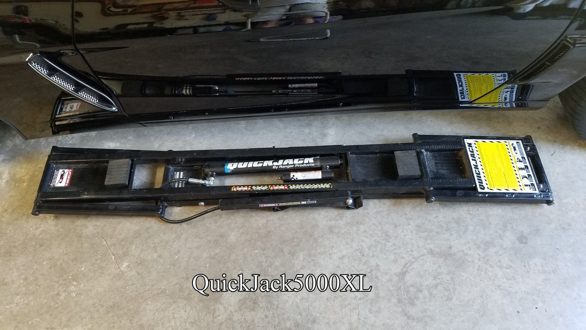

Rubber Blocks in approximate position
QuickJack 5000XL slid into place

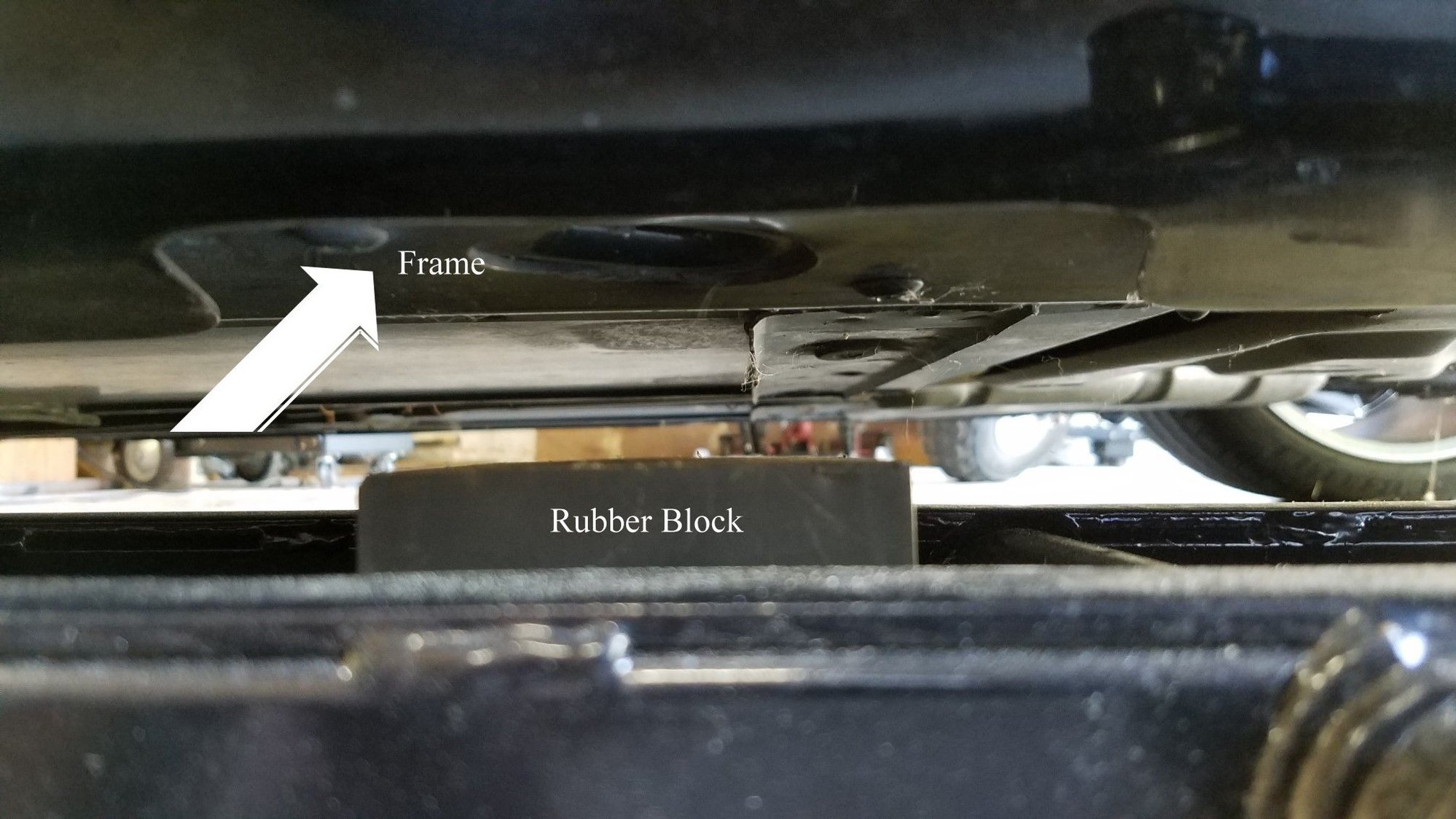

Rear Frame. Using my fingers I fine tune the position of the rubber black.
Front Frame. Using my fingers I fine tune the position of the rubber black.

Thanks for those pictures. Now do those rubber blocks need to be under the holes in the frame? As in your last picture it would seem the rubber block needs to be moved to the right by about 4"?
