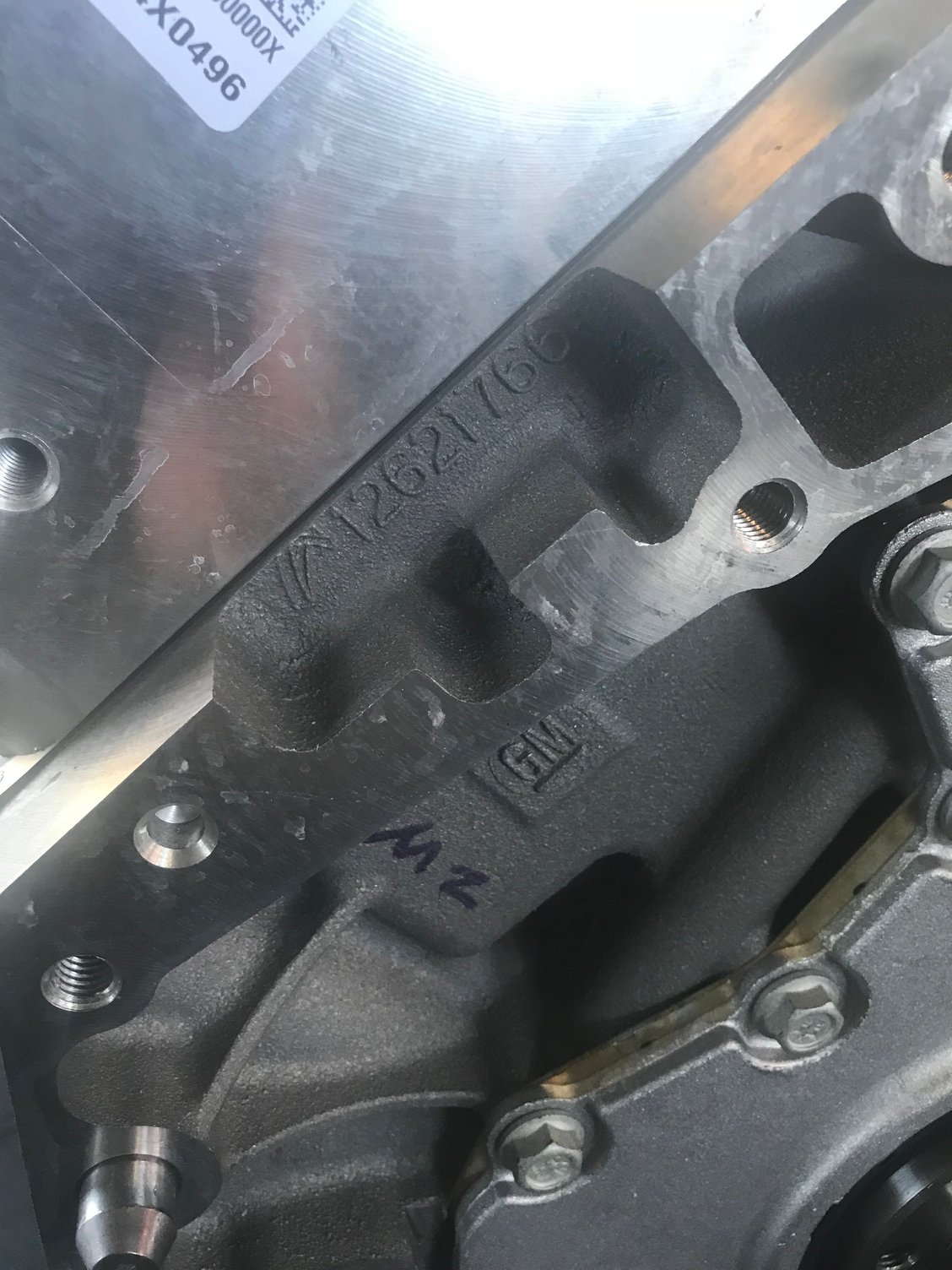

That block casting number, 12621766, is an LS9.

An OE LS3 is an LS3 no what if it came in a Camaro or Corvette, ratings are mostly marketing with a very slight dose of intake and exhaust packaging. They are also a little under rated as they stand in crate motor form.
I wouldn't be shocked at all if late production LS3s used the LS9 blocks; why have two different blocks for the same displacement engine? There's nothing magical about the LS9 block, it's differences are all inside. GM did the same thing with late production LS1s a little after the LS6 came out.
ETA: I just looked up the part number from gmpartsdirect.com for an LS3 for Corvette and one for a manual Camaro; they are both 19256529.

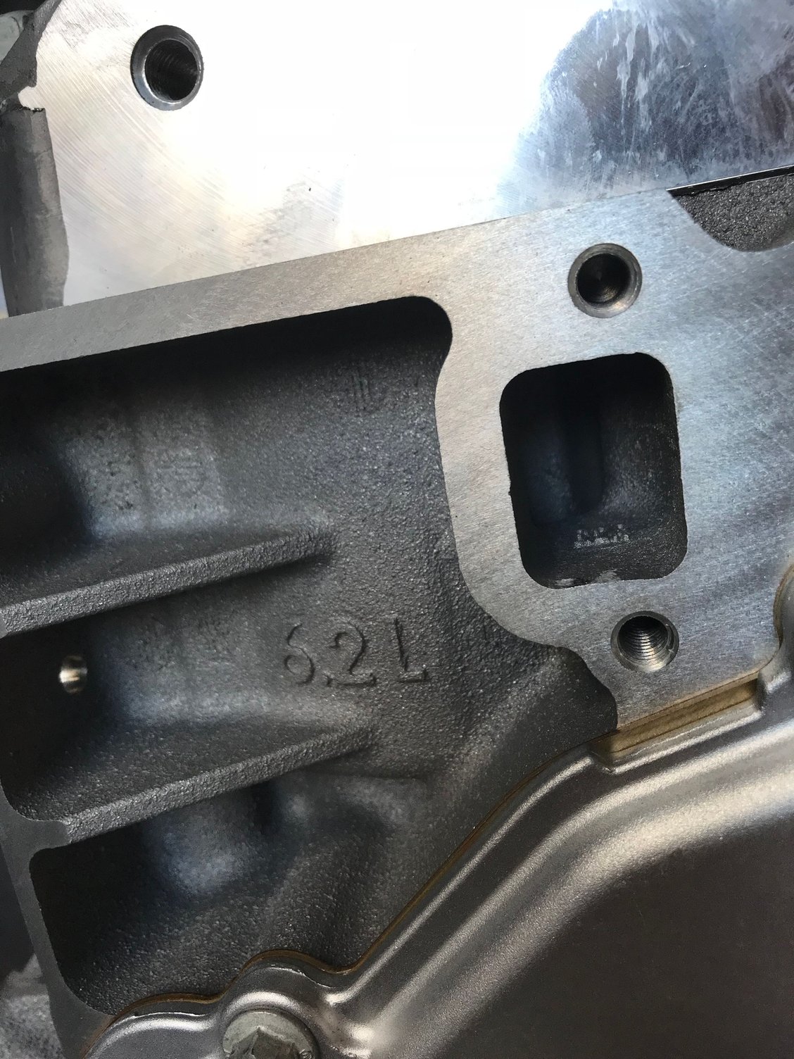

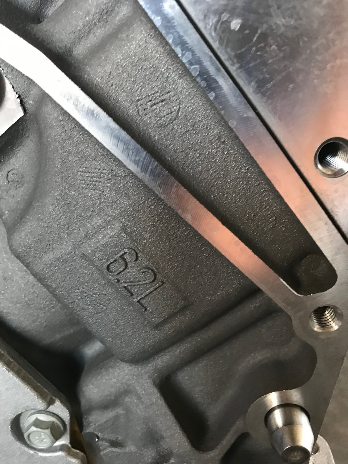

On the side side of the block, opposite the GM embossed logo is "6.2L" on a '08 block, at the same location on a '10 Camaro, it's "LS3". I suspect the casting was changed to "LS3" so it wouldn't be confused with a "LS9".

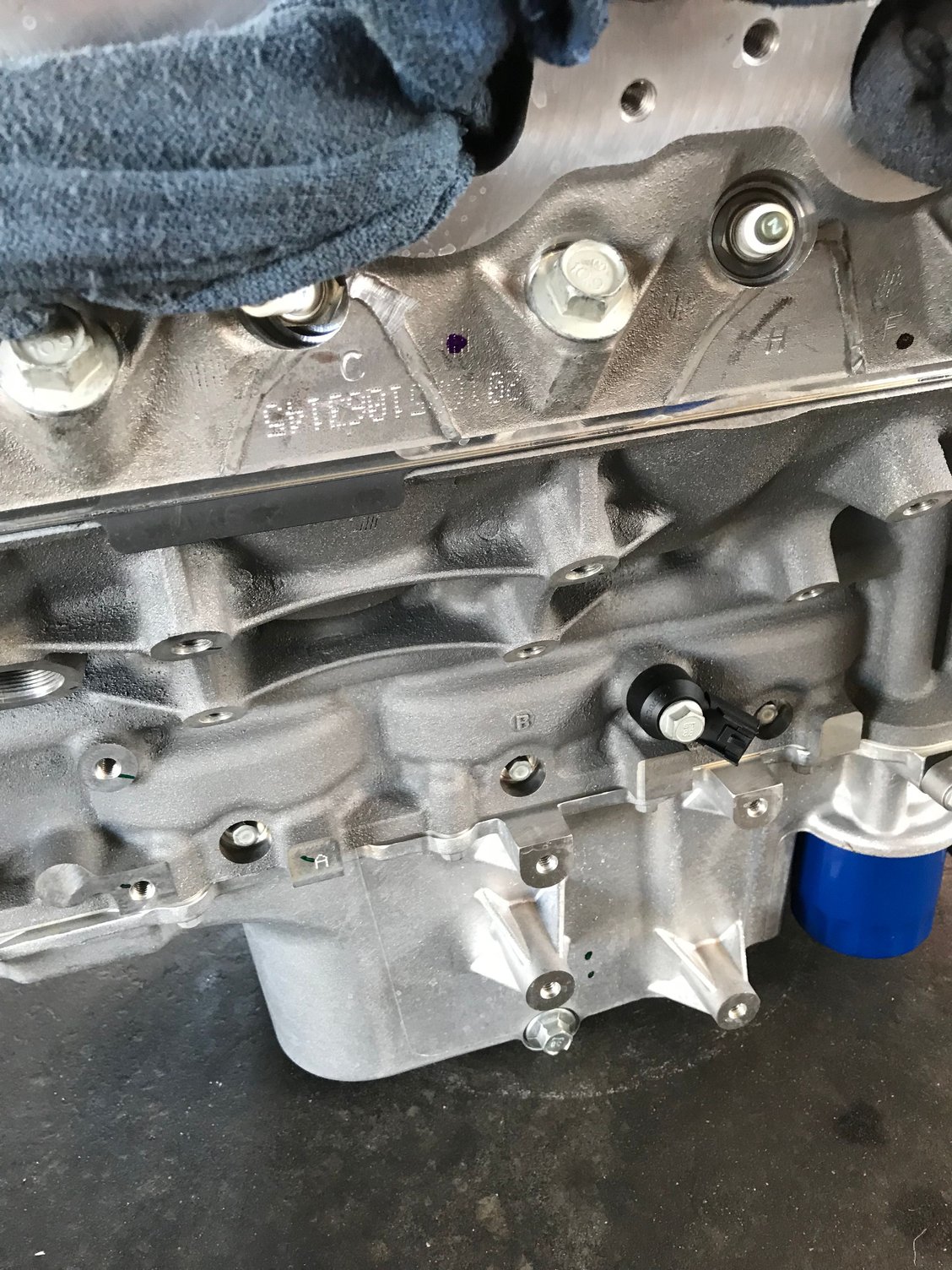

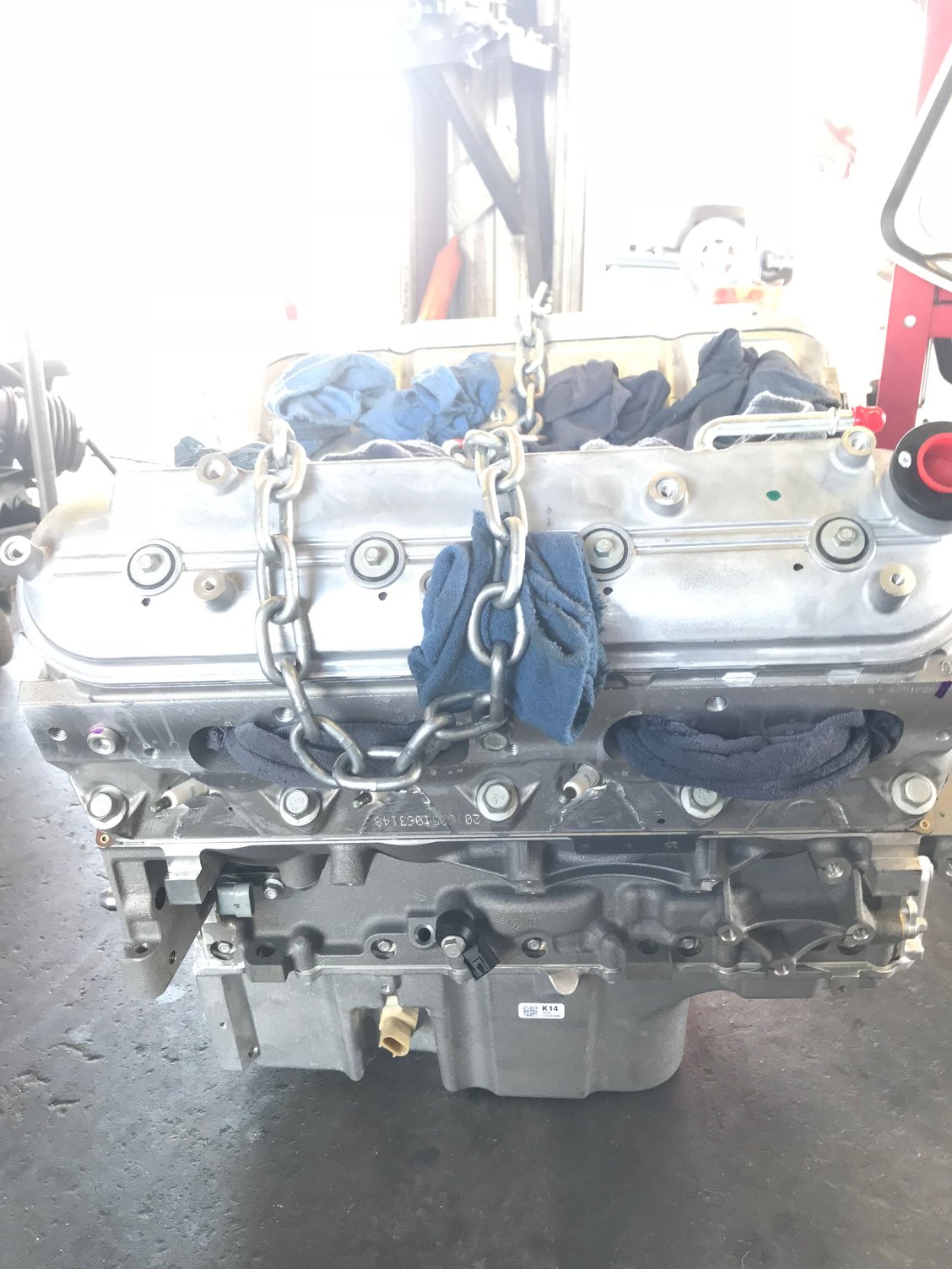

Since all LS9's had dry sump oiling, the crank nose is longer to allow and extra oil pump and the pan has oil line holes on the right side. Take a photo of the right rear and right side of the oil pan. The compression ratio is 9.1 to 1 vs the LS3 10.5 to 1. The boltons shouldn't be a problem, but you'll need to deal with the oiling. With the much lower CR you can run regular gas without pinging.
