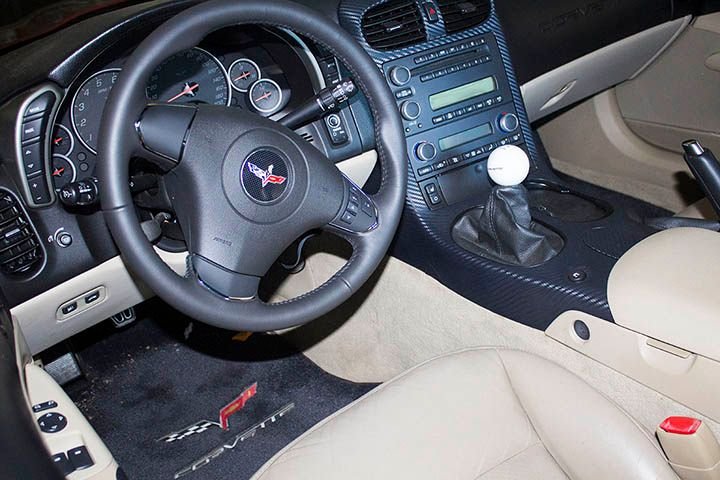

I put a 2012+ wheel on my 07.
When researching it, I thought I read that the clock spring change for the 08 model year was added mid run of the 07s.
Mine was a late build 07 and no problems. Make sure the clock spring is correct if you have an early 07. I may be mistaken on this....been a few years since I did it. I didn't have 3LT pkg steering wheel controls.

I changed to a 2012 wheel on my 05. Only problem was the new clock spring since the connector does not match the harness I had to do small wiring change for the horn.
