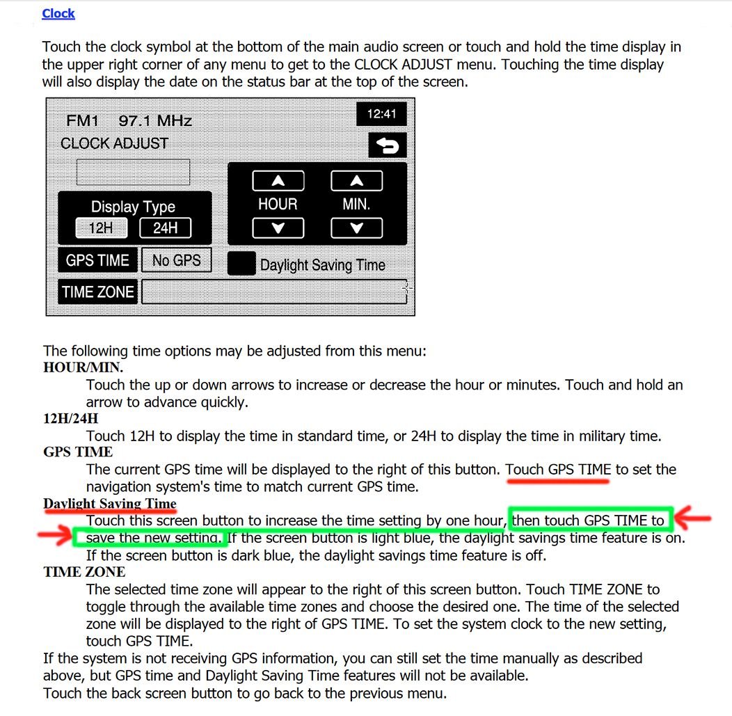

GPS TIME: The current GPS time
is displayed to the right of this
button. Press GPS TIME to set the
navigation system's time to match
current GPS time.
Daylight Saving Time: Press this
screen button to increase the time
setting by one hour, then press GPS
TIME to save the new setting. If the
screen button is light blue, the
daylight savings time feature is on.
If the screen button is dark blue, the
daylight savings time feature is off.

That almost has to be the Daylight Savings Time setting.

Thanks for that info, but no good. Time only resets after overnight. Will keep great time when driving, but when I turn the vehicle off for a few hrs....then it resets back one hour.

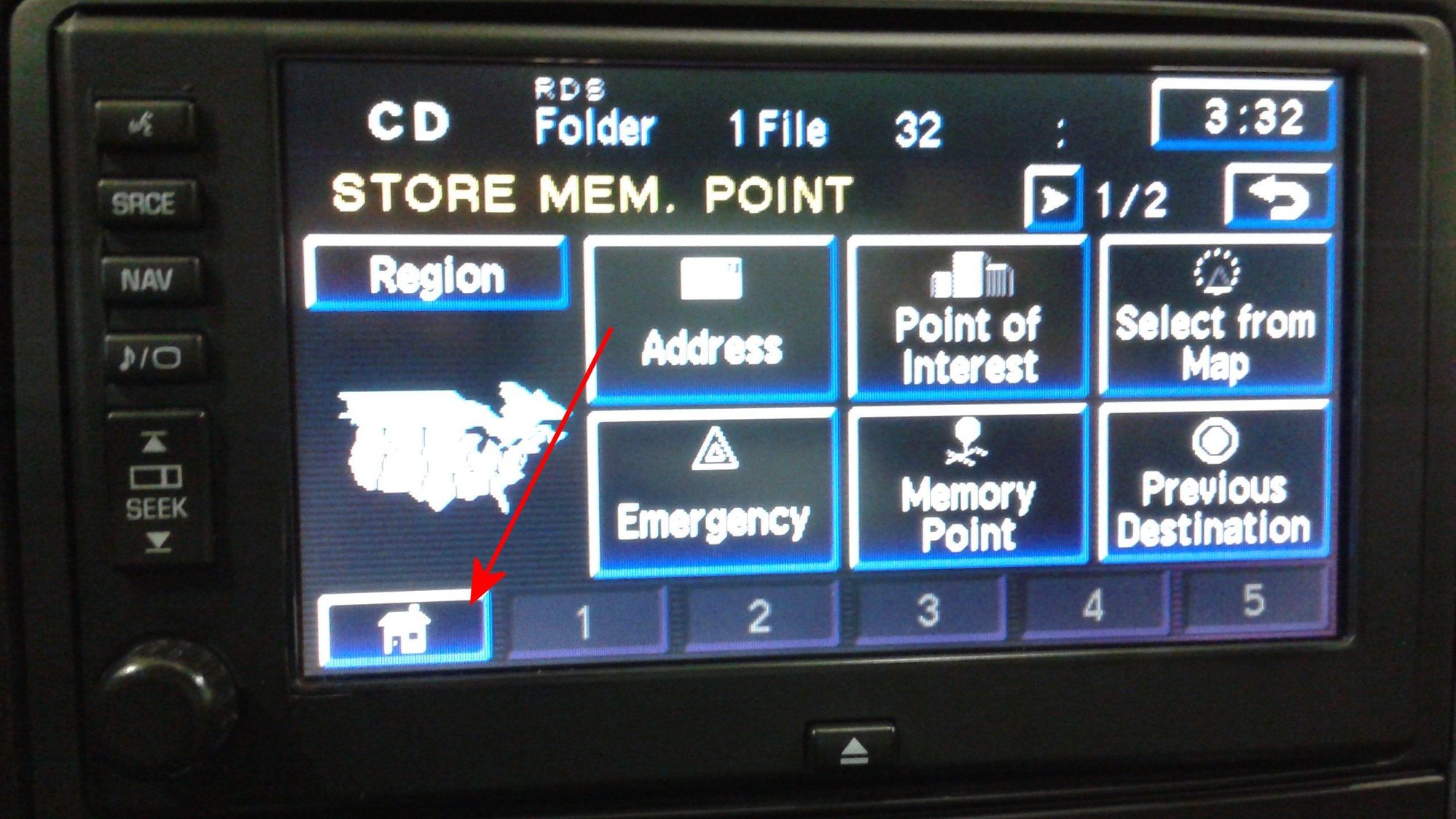

I'm not sure this is the issue, or if this will solve the time shift, but do you have your Nav home button set to your place of residence, which would be in your time zone.
That should set the Nav in the correct time zone. Once you set the clock, it should stay in that time zone.
I've never had that issue with the time shifting.
