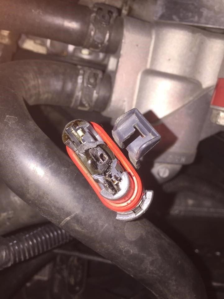

Ditto with this, hence start the engine, turn the A/C on, and the A/C system should turn the radiator fan on.
If the fan does not come on with the A/C on, start with checking the radiator fan connector on the back side of the radatior passenger side, to make sure that the connector did not burn up.
Red laser dot shined on the connector so you can see where it is,
Attachment 48334002
Connector burnt to hell,

I went on huge road trip a little over a week ago and mine shot to 260's in AZ in city driving and then to 281 in stop and go freeway driving in CO At first I thought the pump had gone out
When I got home to WY I found that the hot wire in the electrical connector had burnt up but was internment for a little while until it finally wasn't making at all...
I didn't want this to happen again, so I upgraded to a 6 pole GM connector and paralleled the hot and grounds to carry the current a little better and hopefully not melt again...

The ECM activates the fan speed at 15% when coolant reaches 199*F. Then, gradually increases the % as coolant temps rise reaching a maximum of 90% at 224*F.
It is unclear, if the fan is working or if a tune changed fan speed value to 100% which could melted the connector as Dano illustrated.
