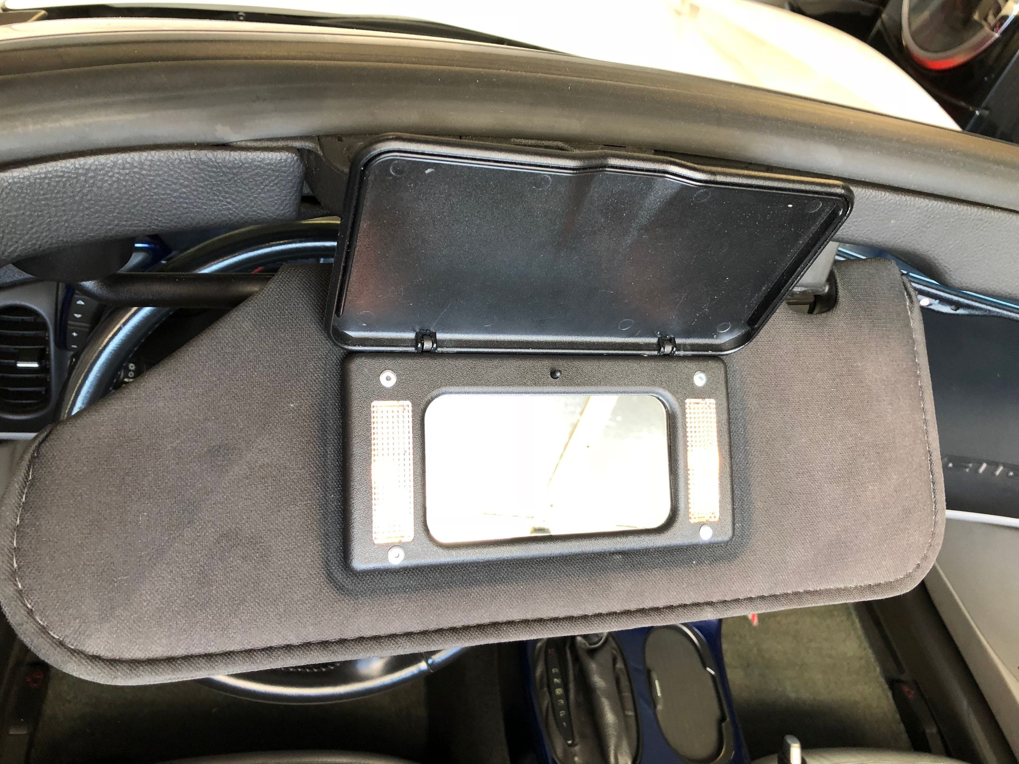

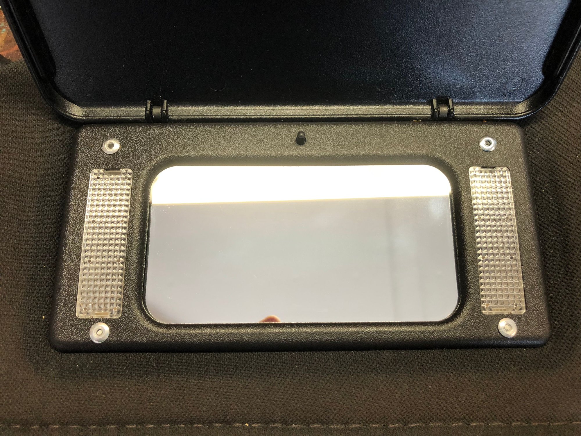

Finished reattaching the mirror assembly to the sunvisor (I previously popped all of the plastic posts rendering them unusable). I used 1/8 inch x 1/2 inch pop rivets. Given that I have a vert, using the zip tie and double sided tape approach did not sound like a long lasting fix. FYI, I have not blacked out the rivets in these pics yet so that they could be seen better.
