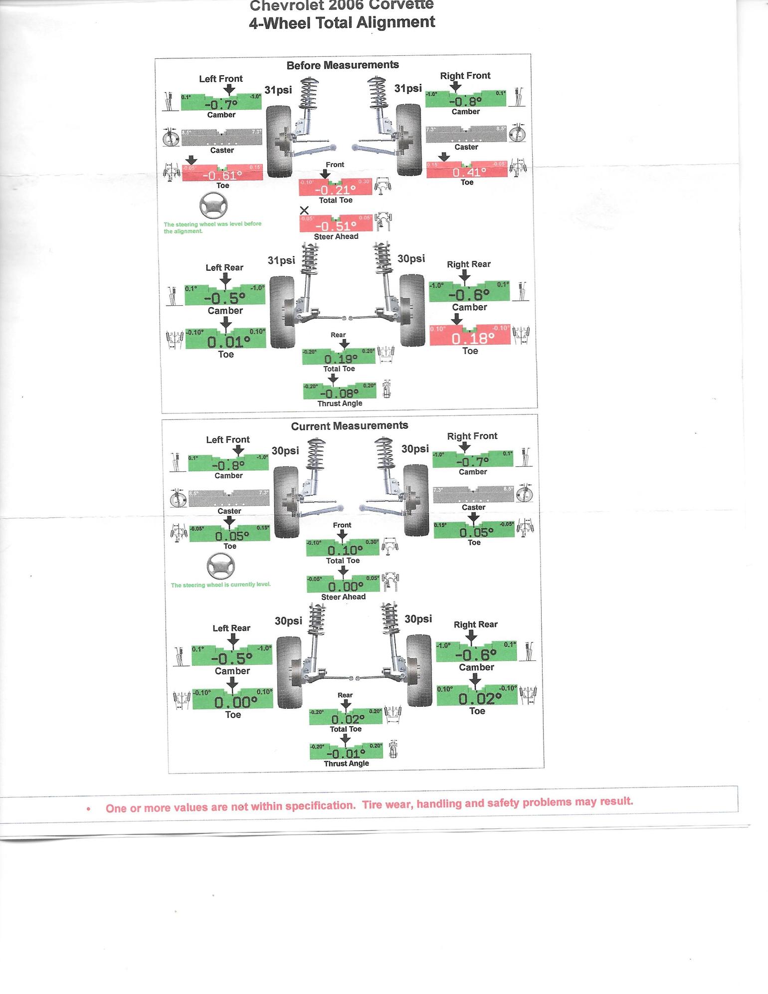

The alignment will not affect any of the items that you mentioned. Any reputable shop can aligne your car so the tires do not wear on the inside. I had the exact same issue, and these are the before and after readings. I've had the new tires on for 2 years since the alignment, and even wear across all 4 tires.

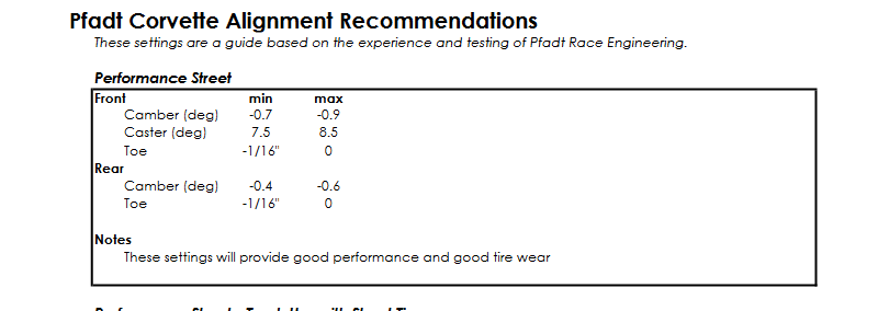

Get a precision alignment with PFADT settings. The factory alignment specs have too much variance (slop). it's pretty common to see the inside tread worn out but the alignment is within factory spec.
you might have to call around for a shop to perform a custom precision alignment.

I think it's a waste of money to get a factory spec alignment. Certainly any shop promising "lifetime alignment" will love it because they may never have to align the car, even if the tires are worn on the inside or it drifts to the left.
I know by experience that my left front was worn on the inside to the cord but it was still within alignment spec!
Get a precision alignment with PFAD specs or even dead centered on factory specs. The factory spec has too much slop.

That's what PFADT specs basically are. No need to go into a alignment place and make it more confusing by giving the tech specs to try and hit. Just set it to dead center of factory and you get the same thing. That's what I have always done with my GS and my tires have always worn even across with great handling.

close but not quite. There are some differences but PFADT is within the factory specs but not dead center in all 5 measurements. Anyway, close and consistent and precise.
Bottomline, don't settle for the slop in the factory tolerances. Get a precise alignment as closes as possible.
Take those specs and split the difference and pretty sure those are dead center GM specs.
