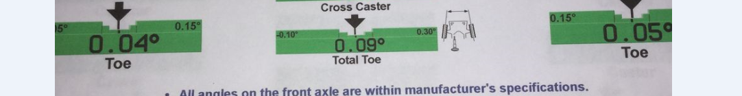

Exactly. I don't know what's so hard when you go to get a alignment. Tell the tech to put it dead center (like this) on all the green bars for all the settings. Really don't understand why these threads constantly pop up all the time.
