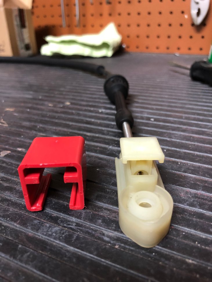

Shifter and trans has to be in park both.
so is it a tran lever problem or did not not adjust the cable correctly.
Hence need to put shifter into part, then trans lever into the park detent, then lock the end of cable to that lenght.
https://www.corvetteforum.com/forums...placement.html
