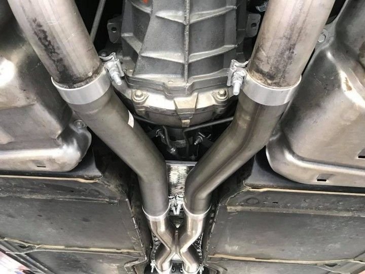

I am seriously considering adding long-tube headers and X-pipe. Seems cheap for this setup from Ebay. But I don't have much to spend. I don't have thousnads of $$$ laying around like some of you. Slowly I intend to modify my exhaust, intake, and possibly cam WAY down the road. IT'S A DAILY DRIVER.
Questions:
1. Would I need O2 connector extensions?
2. Would it need to be "tuned" after removing the cats? (Will the O2 sensors have an erroneous reading without cats?)
3. Any modification required to match this to the pipes running to the axles? I have a welder and can get adapters if necessary.
Thanks in advance.

Next on headers, take a look how the X pipe is going to hook up to the header ends. The slip fit type connectors tend to leak, the bolt on type tend to end up with the bolts loose at some point, and about the best connectors that I have see are the old Pfadt header that used a C clamp instead.

Once you have the headers installed, dry fit the X pipe with high flow cats sections together connected to the muffler pipes as well, use the clamps to secure the pieces in place temperary, then spot weld the X pipe sections so you can drop the X pipe from the car to weld all the X pipe sections together.
Hence the OBX header kit with high flow cats comes with the 4 Band clamps for the X pipe after the cats/before the muffler pipes, and it's these connections once the X pipe has been fitted to the car, that we want to weld instead of using the band clamps (so you don't have an exhaust leak at them isntead). As for the rear muffler to X pipe connection, use the factory clamps.

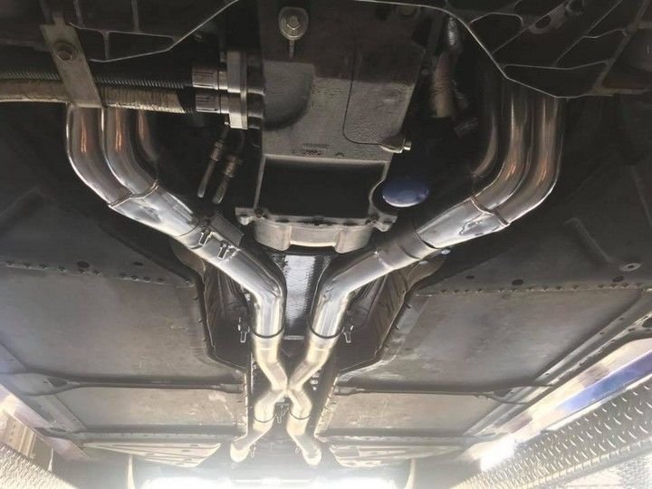

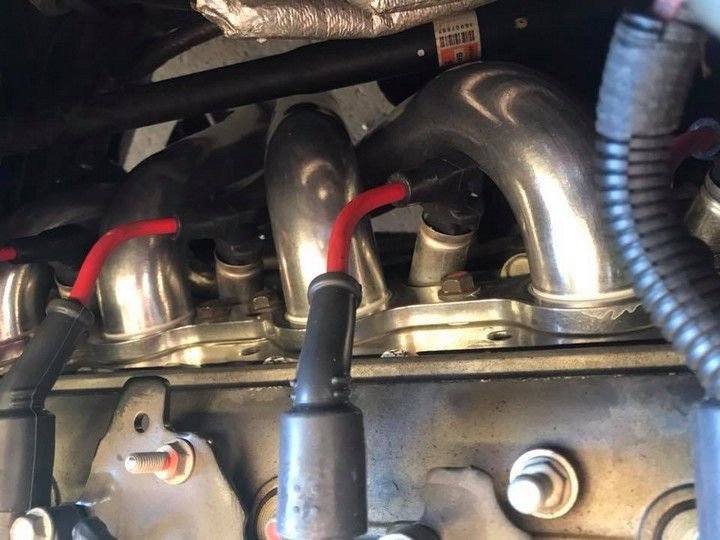

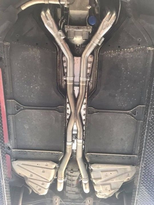

Why would you buy a set of "Made in China" headers on a Vette? We have our Made in the USA TPS Motorsports RPM 1-7/8" Headers on sale right now for $899 shipped to your door which also includes GM Gaskets, Billet Catch Can, and 02 Extensions. I understand your on a budget but you'll avoid alot of fitment issue headaches and we are pretty much around 24/7 to help support you on your purchase if you need help.... from my experience eBay sellers of Chinese made parts essentially will offer you zero support.
Here is a recent review from one of our customers
https://www.corvetteforum.com/forums...er-review.html

^^That fitment looks awesome. Looks like they don't hang down at all. Texas Speed headers are cheap and mine made power, but they hang a bit low. BUT, I am lowered all the way on stock bolts with a bushing cut, so the car is quite low.
Those headers look great Mike, and the price tag ain't bad either!
Good price on those headers, but will I need to buy a new X pipe along with the headers? Are the headers coated, if not how much more for that?

Thanks! If you decide you want to change the Texas Speed out for ours let me know
